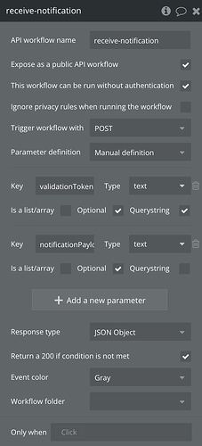

For anyone who might find this useful, I’ve managed to set up a Microsoft Graph webhook in Bubble for change notifications (i.e. a subscription).
This is how:
First, set up an API call to create the subscription. If you plan on doing something else with the notification payload, make sure to check “Return a 200 if condition is not met” - this will ensure Microsoft accepts the validationToken when setting up the subscription.
Then set up an API workflow to receive the notification (this will act as your notificationUrl). You can find the API endpoint in the ‘API’ section of your app settings.
Set up an action to return the validationToken from Microsoft provided that the validationToken parameter isn’t empty.
Then add any other actions you like to use the information in the notification, with the necessary conditions. Doing this is a bit fiddly as it gets processed as a string not a JSON but you can get good results with the Regex extractor in Bubble. I didn’t need to do anything complicated with the notifications so this worked fine for me.
