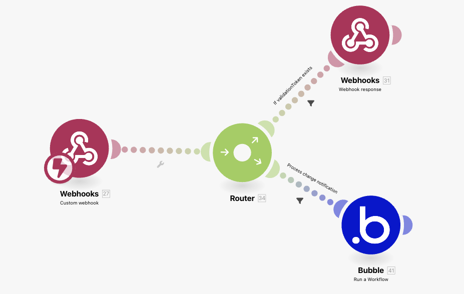

I managed to get a workaround functioning in Make (see below), but I’d really rather get this working in Bubble if possible.

Hey @joshphillips
Couldn’t get this functioning in Bubble, but got it working by building an Azure Function app which handled both the validationToken and updates and then passed the subscription updates onto my Bubble app. There are quite a few resources on the web for this, and was much more economical than dealing with Make.
After I got it working, I realised that it was overkill for what I needed. Ad-hoc and periodic subscription updates served my purpose, so just built this capability through standard graph API calls in the app backend.
