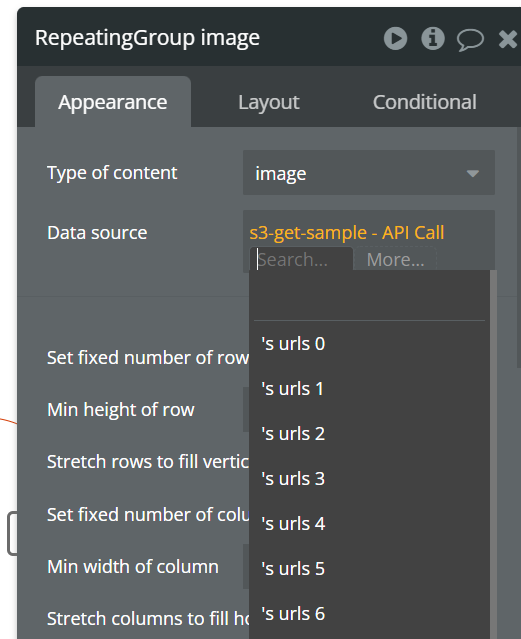

Hi, I’m trying to show a group of images that I get from my api. Challenge is number of lists that I’ll be getting from the API is dynamic. Sometimes I get 2 lists, other times it is 10.
I have managed to use API connector and get the data but I can’t change my repeating group’s data source to all of the lists. I can only select one of them. What I want to achieve is have an extending column for each new list. Some guidance will be helpful since I’m new to bubble and web development in general, cheers.

The problem is the structure of the response. You could use perfectly if you have a json like this
"id": 0,
"images": [
"https://dummyurl.com/image1.png",
"https://dummyurl.com/image2.png",
"https://dummyurl.com/image3.png",
"https://dummyurl.com/image4.png",
"https://dummyurl.com/image5.png"
"id": 1,
"images": [
"https://dummyurl.com/image6.png",
"https://dummyurl.com/image7.png",
"https://dummyurl.com/image8.png",
"https://dummyurl.com/image9.png",
"https://dummyurl.com/image10.png"
To solve this problem you can modify the response in the server if possible or you can write some js on the bubble side.

Changed the API response to this and created a new data type with id and list of images. Now it works, thanks.
