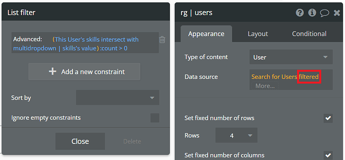

Hi there, @aarti… if I understand your post correctly, you can get the desired result by using an advanced filter that does a count of the intersect between the list of skills selected in the multi-dropdown and each user’s list of skills. In the following example, I used an option set to define the skills, and I have a skills field (list) on the User data type that links to the option set.
If you have never used an advanced filter before, be aware that the filtering is done on the client (browser) side. So, the search is going to return all of the relevant things to the client, and then the filter will be applied (which could have an effect on performance if the search returns a lot of things). Also, the Advanced option can be a bit tricky to find… it is all the way at the bottom of the dropdown when you add a constraint to the filter.
Hope this helps.

Thank you so much, its working…
