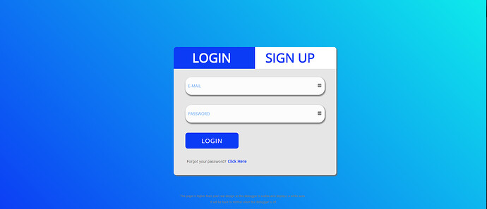

Here is the screenshot when it looks normal:
and here when it jumps to left and padding/margin top increases
it happens at 1079px width

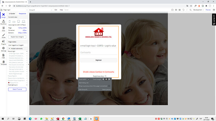

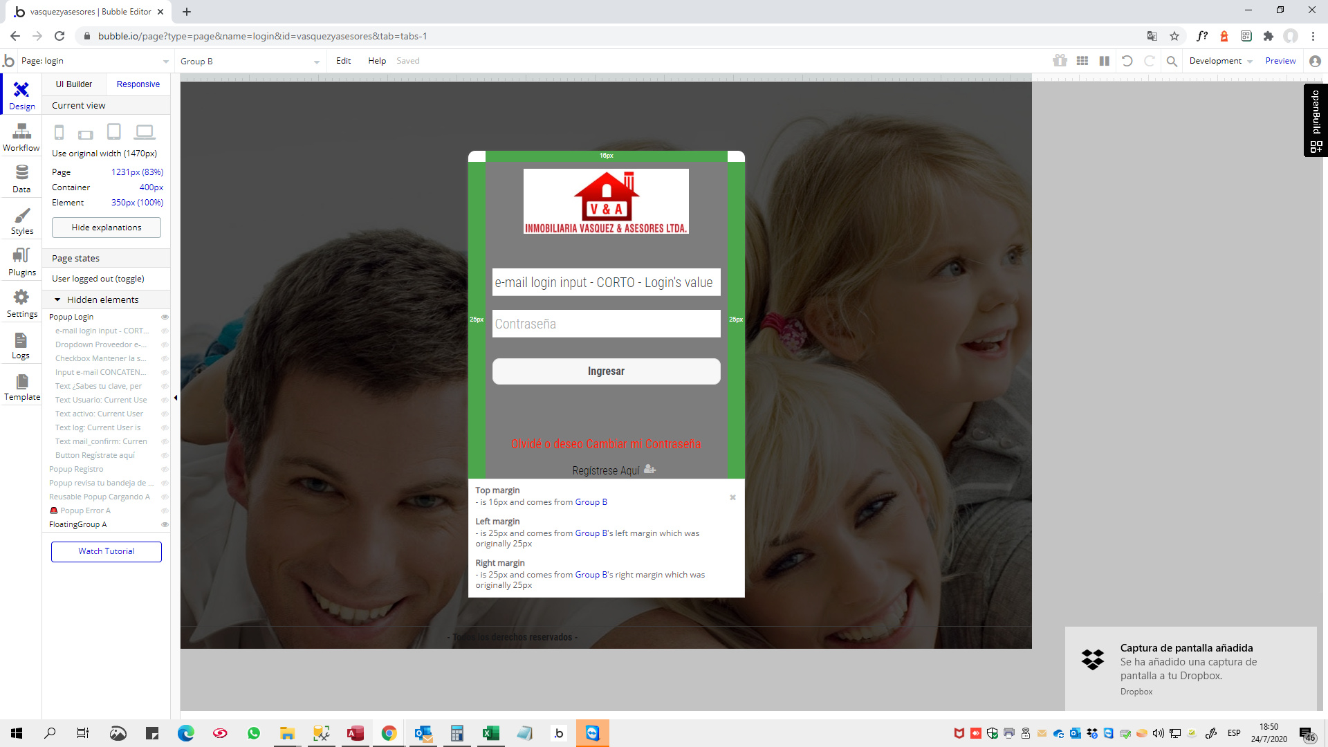

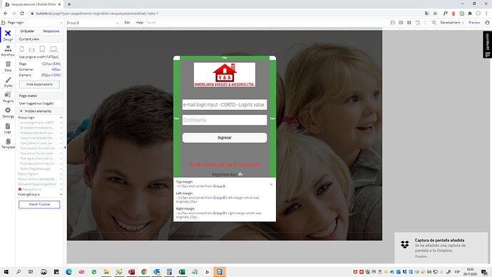

If you click in the left menu bar the button “Explain box Margins”, Bubble will show you too with colors and # of pixels how is the setup and responsiveness for each element that you need.

I used the explain margin feature and found the solution.
So this might be helpful for others using the CSS Tools plugin. I thought it is just a visual representation on the editor while in reality it is rendered as a div and position where you place it matters. My login box margin was at a certain point influenced by this invisible div. So I just put it to the right side, where it makes no problems.
