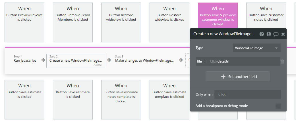

Ok, here’s where I am with this, any help much appreciated.
I am trying to create a feature on my website that allows users to take a screenshot of a specific area of the page and then save that image to my database. To achieve this, I have implemented the following steps:
  1. I created an HTML element that allows users to take a screenshot using the ā€˜snap’ id.
  2. I added a ā€˜save’ button to the page with the id ā€œsave-buttonā€.
  3. I added some JavaScript code to trigger a workflow when the ā€˜save’ button is clicked. This workflow has three steps:
  • a. The first step runs the JavaScript code that captures the screenshot and converts it to a Data URL (code below).
  • b. The second step creates a new ā€œWindowFileImageā€ Thing in Bubble with the ā€œfileā€ field = dataUrl
  • c. The third step makes changes to the ā€œWindowFileImageā€ Thing and sets the ā€œfileā€ field to file = dataUrl
  1. I tested the feature and found that the image is not being saved to the database, I think the issue is the naming of the file = ā€œdataUrlā€ (see image below). I guess I am not able to rename the image file when it is saved to the database, I don’t know how to do this?
