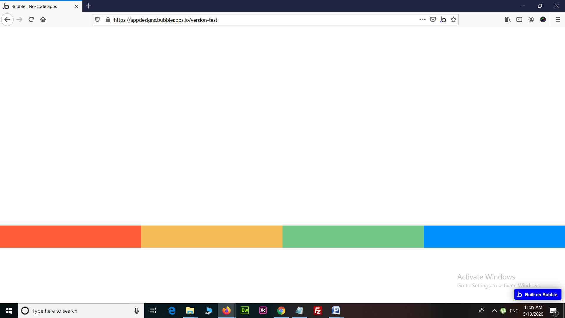

I have one more issue . can you help me out . I want to put my footer bar at bottom of screen when it open on any devices ,it should stick at bottom screen ( desktop / tablet / mobile ). I want to show like this in the give image. I am not able to do that. can any one help me out , how it can be possible.

Your footer needs to be a “floating group”. Also in its settings, it needs to connect to the “bottom” of the page. That should give you the desired look.
Hope that helped.

I need footer to stick like this in the example , even if the page scrolls.

I use the floating group but not able to get like this.
Is this what you are trying to accomplish? https://multisellercheckout805.bubbleapps.io/version-test/footer?debug_mode=true

Thanks . It help me lots. I have one more issue , can you solve .

It is just using a floating group. Just put it at the bottom of your page and then check it as “bottom”.
