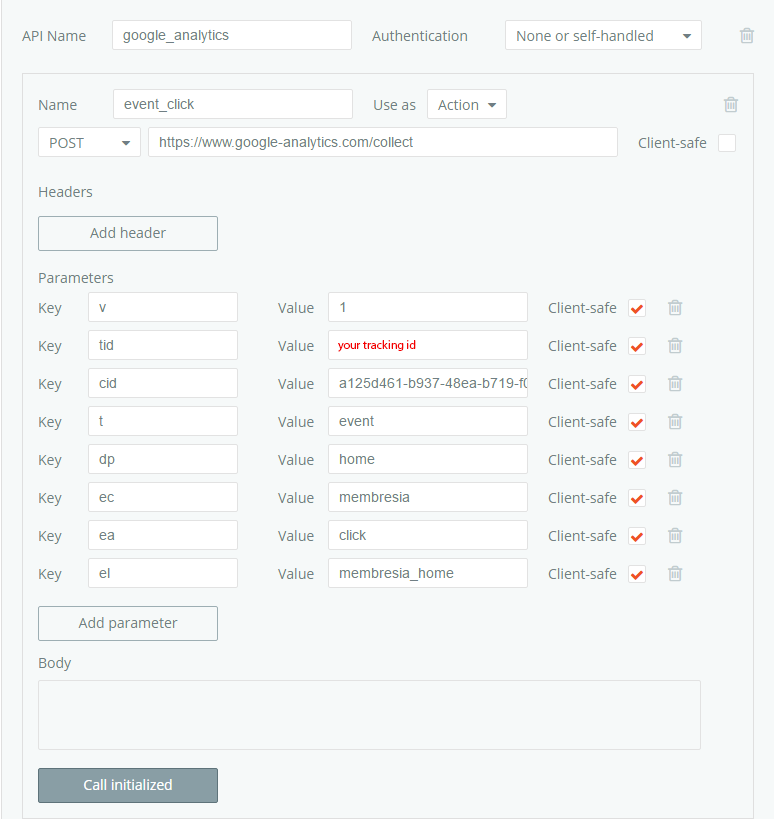

Hey @vaughnwibbles I was having a trouble with that too today, but fix its pretty simple. A little late but probably will help someone else.
  1. Check this link Working with the Measurement Protocol  |  Analytics Measurement Protocol  |  Google for Developers
  2. Use this configuration to do de API call POST with Bubble API Connector
  1. Use API call in button workflow
  2. Enjoy!

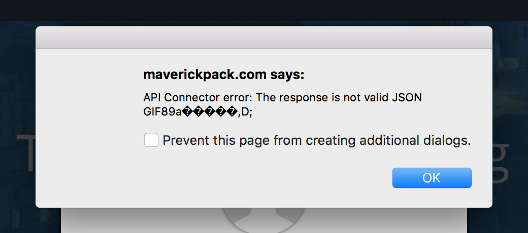

How does the cid work? Are you using the user id? I’m getting an error.
Error

I don’t think this API is json, but xml
@emmanuel I tried checking XML data and initializing but get an error now. Also got the same error as in my previous post when attempted to complete the event in the workflow.
I am fairly certain it isn’t XML. The issue is that the response is basically a null image. You don’t get a response code etc.
In this case the response should just be ignored, but bubble wants something back.

It looks like “Image” is now a possible response format in the Bubble - so set the GA Event post to have that as a return … and it works.
d
This should mean the other “image” response APIS will now also work.
