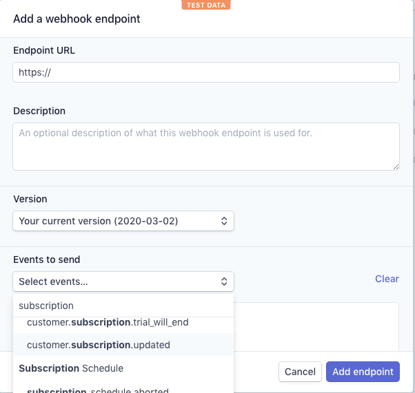

  2. In Your Stripe account you need to create a couple of webhooks → This is found under the developer’s menu item
    Screen Shot 2020-09-07 at 6.32.27 AM

  1. In Stripe Create a webhook for when subscription is updated
  2. Paste previously copied URL (from bubble) and paste in ā€œEnd point URLā€
    Click on Add Endpoint and Send Test webhook
  3. Go back to bubble. Bubble and Stripe now will make a connection where stripe will send a whole bunch of data to bubble - make sure you create a record in your newly created table and capture the Invoice_ID, Subscription_ID and Customer_ID
