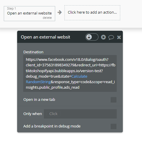

Now, I did solve the issue by using a different method, which is using the auth dialog auth through a an external link workflow, check the pic:
This works, but what I want is to use the social login workflow, to properly setup the API, this way:
