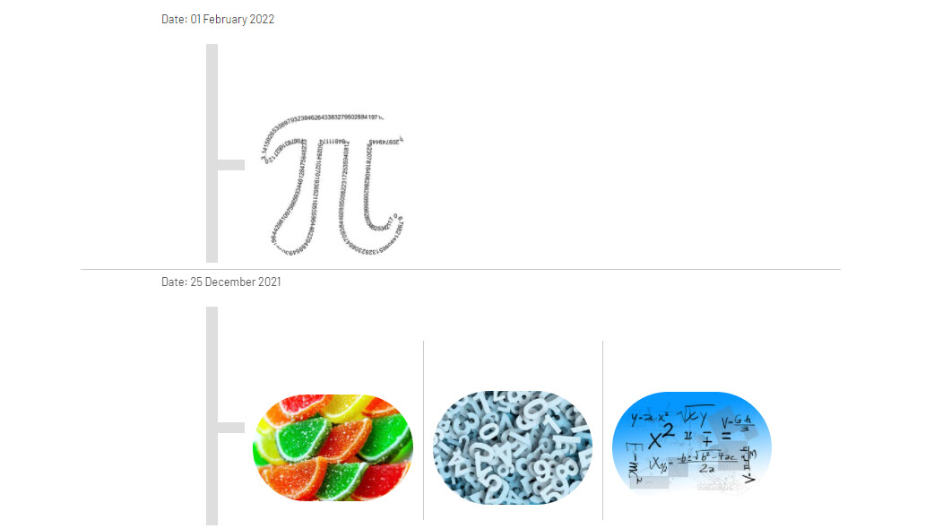

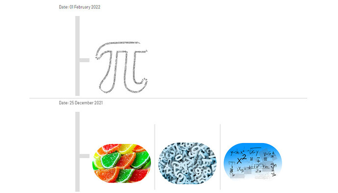

Hi everyone,
I would like to create something like this:
I use an RG inside another RG and what happens is this:
As you can see, there are four entries. One on 01 February 2022 and three on 25 December 2021.
I would like the entries posted on the same date to appear under that date only. Right now, I get three copies of 25 December 2021.
What should I do so that all entries posted on 25 December 2021 only appear once?
Thank you.

@Eugene_West Thank you. I forgot to say in the original post that all entries on this site will be made by the user, so I don’t actually want to display them in a calendar - just want a long list like in the picture in the original post.
I found a post (Group by Field in Repeating Group ) which has a similar problem to mine. How can I do this but with date instead?
