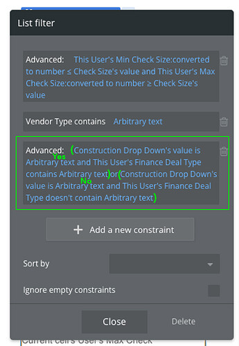

I am trying to write an expression that filters a list of users based on a dropdown with Yes/No options. If yes, search the user list by “a”. If no, search the user list by “b”.
It seems that I need parentheses, but Bubble won’t add them. Maybe I am approaching this the wrong way.
ICYMI:
  • Bubble expressions are evaluated sequentially from beginning to end. You can’t control the order of operations using parentheses.
  • If your list is coming from the database (as opposed to already being on the user’s device), using the advanced constraint requires downloading significantly more data, and, therefore, consumes more workload units, than other constraints, which are delegated to the server.
Consider using separate actions or events to apply the two different filters. Put a condition on each that reference’s the dropdown’s value.
