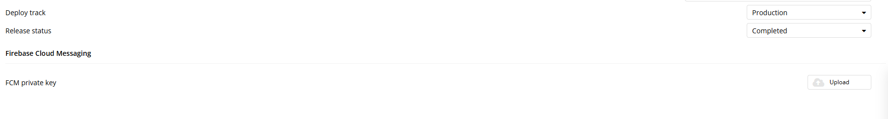

Also would be great if someone can explain to me what deploy track and release status selection means
I leave my Deploy Track set to Internal and the Release Status set to Draft. This really only matters once you have one build published, from what I can tell, because you’ll have to manually upload the first one. Then after you manually upload the first one as long as you have everything else set correctly Bubble will start uploading them.
