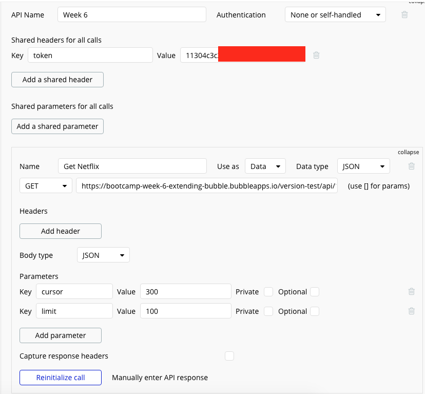

I’m getting 404 not found errors when attempting to initialize api calls to other apps of mine…the strange thing is that they worked previously…the difference is that I enabled access and then disabled it and came back a few weeks later to enable it again and now it won’t work.
I’ve checked that my setup is correct on the apps and they seem to be correct
This is the error I get
This is only the case with new API set ups…so I have an app that had its API enabled weeks ago and it works fine, but I’ve attempted at least 6 other apps to enable API for first time and all are creating the same error in the application I am trying to set up the API calls within.

It’s been a while since I’ve used this. But, should the Key value be Authorization And Value be Bearer 1234..?
I don’t believe it is necessary…I have never needed to use that before, and I have an API to another one of my Bubble apps that is working with the same setup as the ones that are not…the only differences that I can tell are that the ones not working, the apps providing the api are enabling the api while the ones that work the api has been enabled for a few weeks.
This is an api call in the same app I’m trying to set up the others in…the app providing the api had the api enabled a few weeks ago and it works fine
Trying the suggestion like this
results in the same 404 error.

Looking through some of my older apps, I seem to always have used the method I mentioned above. I forgot to mention that the Authentication type is Private key in header.
Trying your way resulted in the same error. But this seemed to also have worked, and came from the reference manual. This is using the Authentication method of None or self-handled.

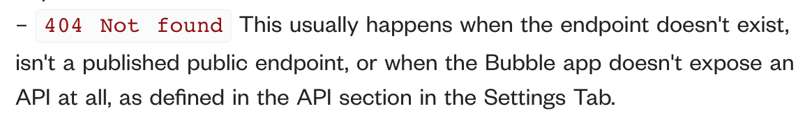

I found this section from the link you provided describing error codes
So it seems to validate my thought there is a bug with Bubble in how they are creating API endpoints at the moment.
All the apps that had the api enabled in the past work…but trying to create a new api endpoint in an app currently is not working; the setup is showing the URL and everything, but consistently getting the 404 errors.

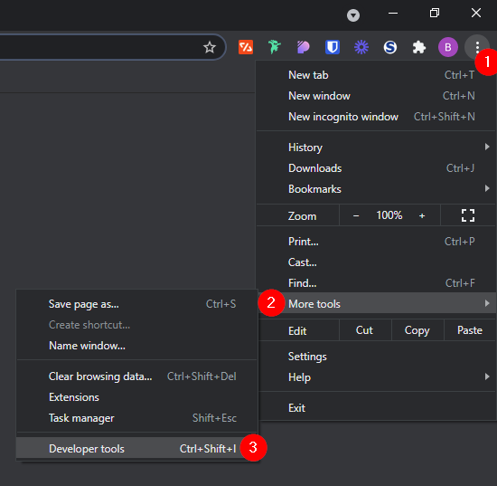

One last thought to try… is empty cache and hard reload on the editor page. Not sure what browser/OS you’re running or if it’ll make a difference.
Chrome for example:
Click and hold the refresh button, then choose the last option. Then try the api call again.

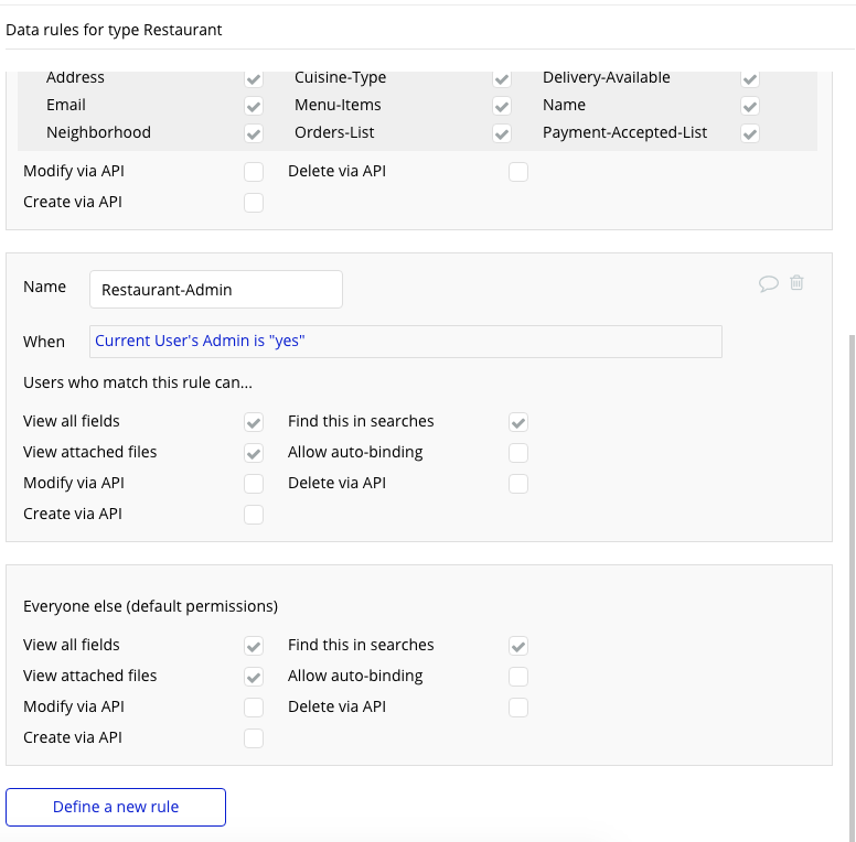

@boston85719 try adding “obj” before your object type in the url. And be aware that your items as of now is public (e.g. you have not set any privacy controls, so I can fetch them even without using your token…)

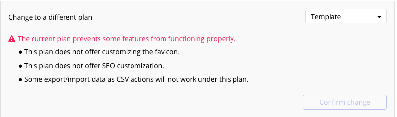

I’m actually having problems with apps on template and instructor plans…both of which should provide access to the api
Understandable that the free plan doesn’t allow for it…they should definitely consider putting some sort of notification on the api section of the settings, rather than just on the plan type area; a UX that would provide a popup that notifies users on free plans that the api can not be exposed when they go to check the box to expose it, rather than make it seem like it is set up properly.
Must be in the attempt to make the changes, they also changed the template and the instructor plan as well.
