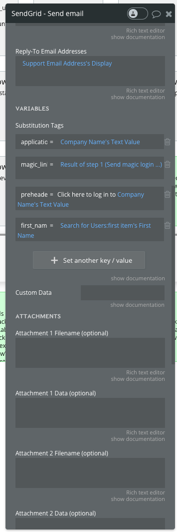

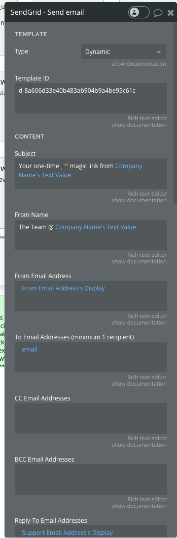

I’m struggling to get my Sendgrid email to send at all. It references the Send magic login link workflow output and has been done in a back-end workflow. Anyone else experience issues with sending a Sengrid email with the link? Here’s my setup:
