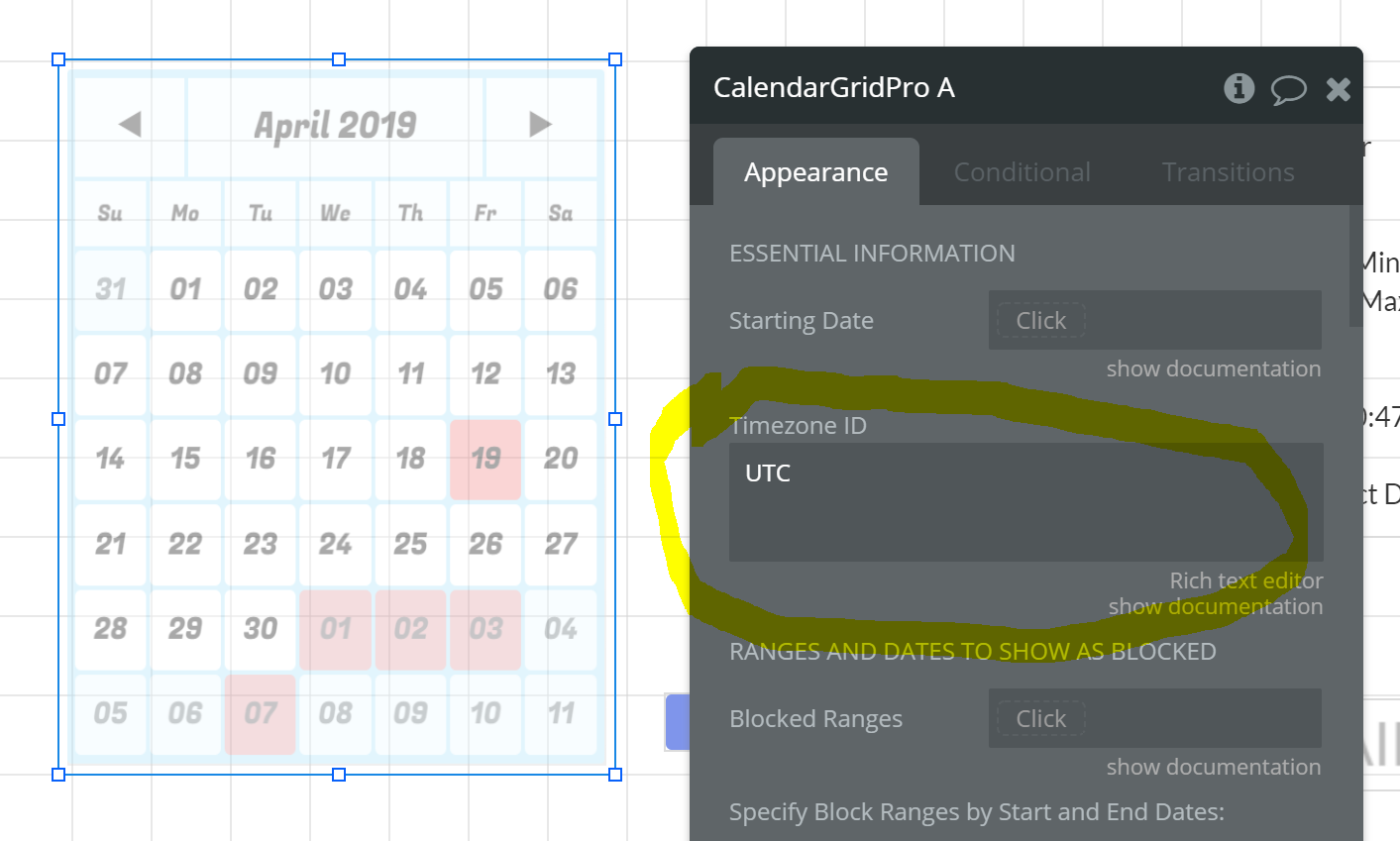

This is what the TIMEZONE ID field is for: It lets you construct your dates in the target timezone, not the stupid browser timezone. :wink:
The CG Pro element shown below will spit out dates in UTC, for example:
If the timezone ID field is empty, CG Pro works like most other date/time pickers – it’ll spit out dates in the browser timezone, whatever that is.
When the timezone ID field is set, any blocked dates you supply are interpreted as being from that timezone as well. (So, you see you don’t have to convert anything. If you ingest all blocked dates [for example] in UTC, everything is hunky dory.)

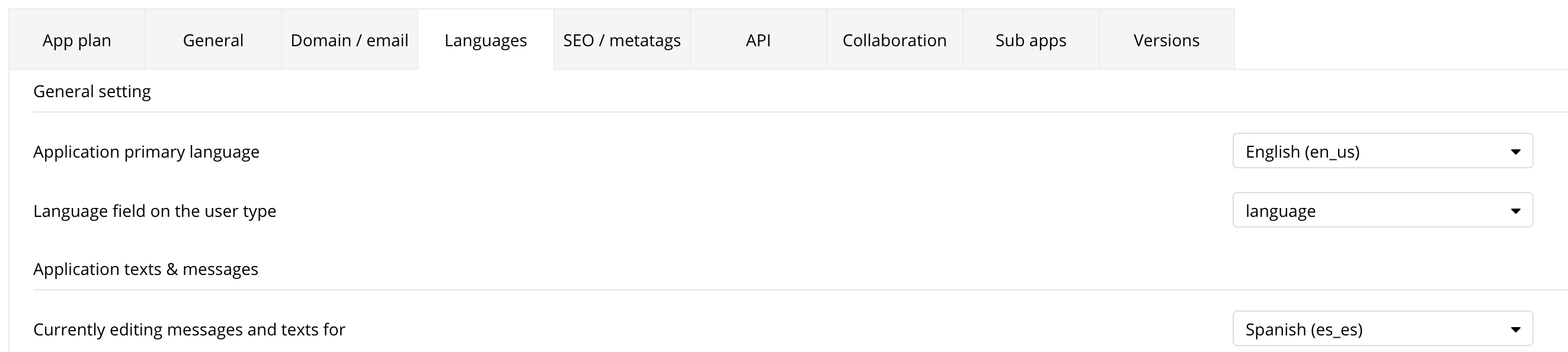

I’m able to retrieve the locale (e.g. es_es) on page load with your plugin, and save it in a “language” field for the user (even if the visitor is not signed up, so there’s no real visitor on the database). I’ve lowercased the locale provided by your plugin and substituted dashes with underscores for that locale, so that “es-ES” becomes “es_es” (what Bubble seems to detect as a language). This successfully retrieves the language of the user.
Also, I’ve translated from English to Spanish all the texts on my app from the Settings tab, after setting the field “Language field on the user type” to “language” (the field in which I save the output from your plugin).
So, when a user loads the page, the locale is detected on page load and the language is saved for that user, regardless of the user being logged in or not (cool!). The issue is, to display the translated texts, the user needs to refresh the page to re-load the texts the detected language (the texts are not updated on the fly).
The question is: Is there a way to update the texts visible on page once the language is detected without having to force a page refresh? Thanks for the help!

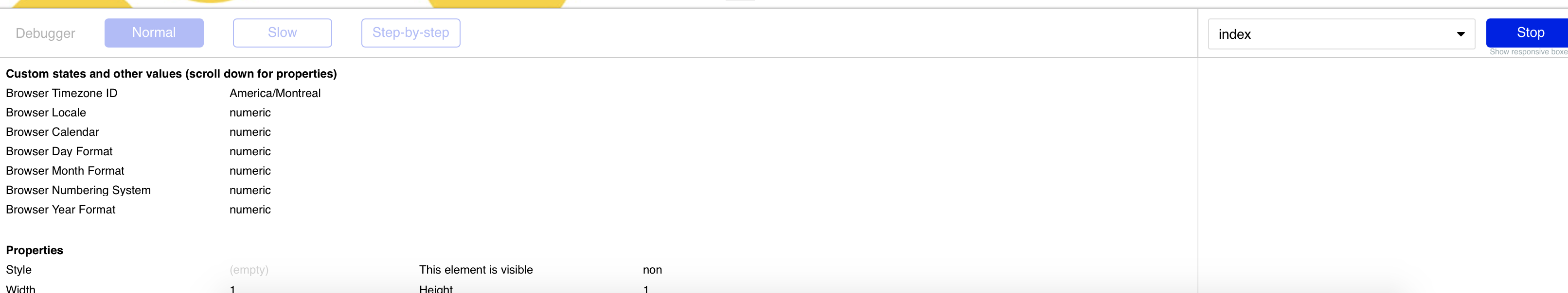

Hey @keith, same issue than @rio; The Locale doesn’t work. It’s showing as “numeric” like the date formats:
Hi @julienallard1 (also @rio): This is apparently a bug in the Bubble plugin editor (which has surely broken many simple plugins). I’ve fixed the issue for Browser Timezone and Locale by moving state publishing up to the code initialize level, instead of relying on Bubble’s “state initialization” routines.
To fix, just update your Browser Timezone and Locale plugin to version 1.1.0. (And post here if you have any additional problems.)
Sorry to hear that this has been broken for so long. I’ll be posting a rant and reporting this formally to Bubble. Shit like this pisses me off.
