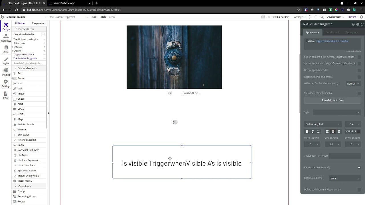

In my quest to optimize my page load speed I decided that I needed a way to lazy load elements. So I present to you my first plugin ever. This improved my lighthouse speed tests significantly on an app for one of my clients and I thought that others might benefit from it as well.
All this element does is check when all of the contents of a group or element is finished loading and then returns a “yes”. This “yes” can trigger a workflow or be seen as a state of the element.

Hello everyone! I’m happy to announce the newest addition to the Finished Loading (Lazy Loading) plugin. Trigger when visible!
This element will set it’s state to yes when an element is visible on a client’s screen. You can set it to trigger only once or multiple times and you can change the percentage that must be visible to trigger.
There was a huge boot to the lighthouse score on one of my client’s apps when I implemented a cascading scroll loading effect to their landing page. It went from a score of 12 to a score of 34!

@StarrK_Designs is it possible to have the ID attribute the TriggerWhenVisible element refers to be dynamic? I can give each cell a unique ID (screenshot attached), but can’t replicate the ID within this element because it doesn’t support dynamic data.
I’d like to include this element within each cell of the repeating group and understand whether a cell is visible or not at any given time. Thanks!

@jack211 I just pushed an update (V1.3.0) for the ID attribute to be dynamic for both elements. Let me know how it works for you!
@StarrK_Designs works great so far!
I’m getting an error in the console though. Not sure if this was happening beforehand or not:
“The plugin Finished Loading (Lazy Loading) / element Trigger when Visible threw the following error: TypeError: Failed to execute ‘observe’ on ‘IntersectionObserver’: parameter 1 is not of type ‘Element’.
at eval (PLUGIN_1618252591952x444708572456812540/Finished-Loading–Lazy-Loading–update–Trigger-when-Visible-.js:43:11)
at https://dhtiece9044ep.cloudfront.net/package/run_debug_js/d543dc12d7f33d6288936dd72f27c6519924743d254226d184e13777c0aee354/xfalse/x15:6:2287492 (please report this to the plugin author)”
Have you seen this before? It seems to be working correctly, but my concern is that this could be impacting performance scores of the site (which can have downstream effects on SEO and other page ranking).
