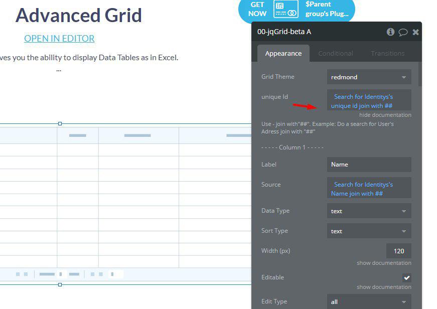

Hi I’m experiencing this error:
The plugin Advanced Grid / element Advanced Grid threw the following error: TypeError: Unable to get property ‘split’ of undefined or null reference at Function code (Function code:4:163) at Anonymous function (https://dhtiece9044ep.cloudfront.net/package/run_debug_js/48791719dd7cea0b330ad1555129c97d3bb64ae99fc0d4e7c23f47ace503c59f/xfalse/x5:15:1921476) (please report this to the plugin author)
On the page I only have a Date/Time Picker and the Advanced Grid. The advance grid is connected to a SQL Connector to get the data.
Also I’m using the whole 20 fields available on the plugin.
Any help appreciated.

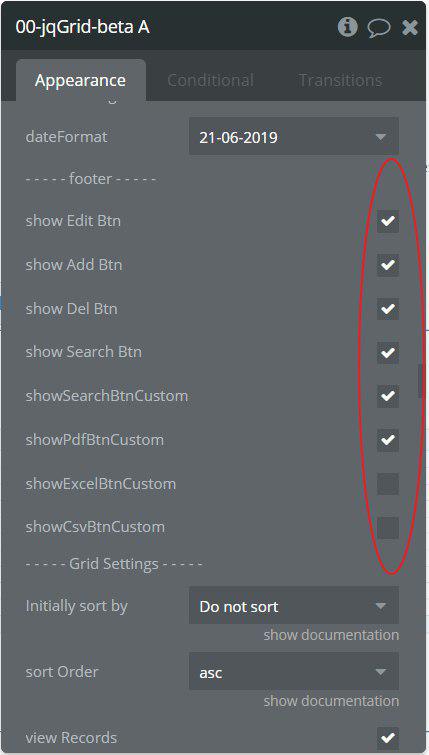

Now I’m having issue where when I add the pdf, excel, csv buttons they don’t show up. Well, they’re there, but they’re hidden by the navigation buttons. What’s the solution here?
See below.
Thanks,
George
Hi @gnelson,
Thank you for the info you’ve shared regarding the issue.
So the first problem seems fixed.
And the second one where there’s no buttons - the width of the table here is too small from the looks of it, and the elements of the table are fixed. And if the width of the table is quite small they start to go over each other. To make a more specific analysis and conclusion we would need to look into the app.
What you can also do - remove some spare buttons to make the footer thinner so that the buttons would not overaly.
Let me know if I can help with anything else.
Hello,
Well, I only took a snapshot of the left corner of the grid. The grid actually stretches across the entire page. The navigation buttons are all moved over to the left corner of the grid instead of in the center as usual. In troubleshooting I’ve removed every button and nothing changes. I’m thinking somehow the grid is corrupted. I placed another element on the page for test and it behaves correctly. So I figure the easiest fix is just use the second grid and delete the first one.

Hi @wpabon,
Sorry for the late reply, I seem to have missed your message previously.
The team thinks that the issue lies with “Join_with##” , please check if you haven’t missed this when setting it up.

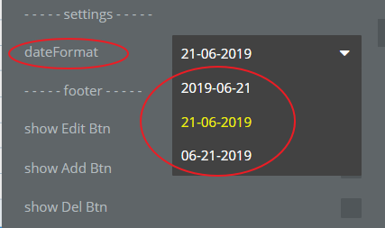

is it possible to do a custom formatting of the columns? i.e. for a date field?
Hello!
Unfortunately there are no custom field settings.
In the date field, you can select one of the three options for displaying the date.
Image 17
