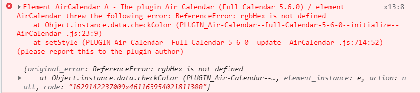

Hey @ZeroqodeSupport unfortunately, I’m still consistently having issues with the calendar. One thing that’s interesting is that I’ve got the calendar in a reusable element. It’ll often work perfectly on one page and throw errors on the other. What’s strange is, the data source and how it searches for it is specified in the reusable and doesn’t change at all. So, it seems buggy that it would work on one page and not on the other. In addition, which page it’s working on seems to change. Sometimes it’ll work on my dashboard and not work on the calendar page. Other days, it’s the opposite.
It’s also worth mentioning that almost anytime I change the version of the plugin, it’ll seem to start working and then the problem returns after a couple of days. It almost seems like cache issues or something that go away when an update is pushed and return after its had time to cache things again. (Totally a guess…)

I am getting the same error intermittently. I then simply change one value typically Custom view duration in the plugin on the page and republish and it fixes it. It tends to happen when I’ve edited other visual elements that are on the same page as the calendar.
Yea, I’ve also found that making changes can sometimes help temporarily. The problem is that it’s not always a convenient or possible option to deploy to live just to get the calendar working again. :-/ Really need the stability and dependability back.

This problem only happens when I edit (or deploy) my app. Even if I change a small thing in another page without the calendar, sometimes, the calendar starts to throw this error message and stop working.
Sometimes it works in development, but the live version is broken… Sometimes is the opposite. It is impossible to know what is going on.
And as I said and you guys could see, we just need to open the calendar and change anything in it’s parameters to make the error disappears. In my case, I always change the ā€œEvent Titleā€ field to a blank option in the dropdown than I change it back to the right option. Sometimes this fixes the problem. Sometimes I need to do it up to 15 times (as last week) until its ā€œbootsā€ the plugin.
Very frustrating…
And the problem is that I have the calendar in more than one page (4 pages, with different configuration), so it is common that the fix for one calendar in a page A breaks the calendar in page B, C or D. It is a patience game…

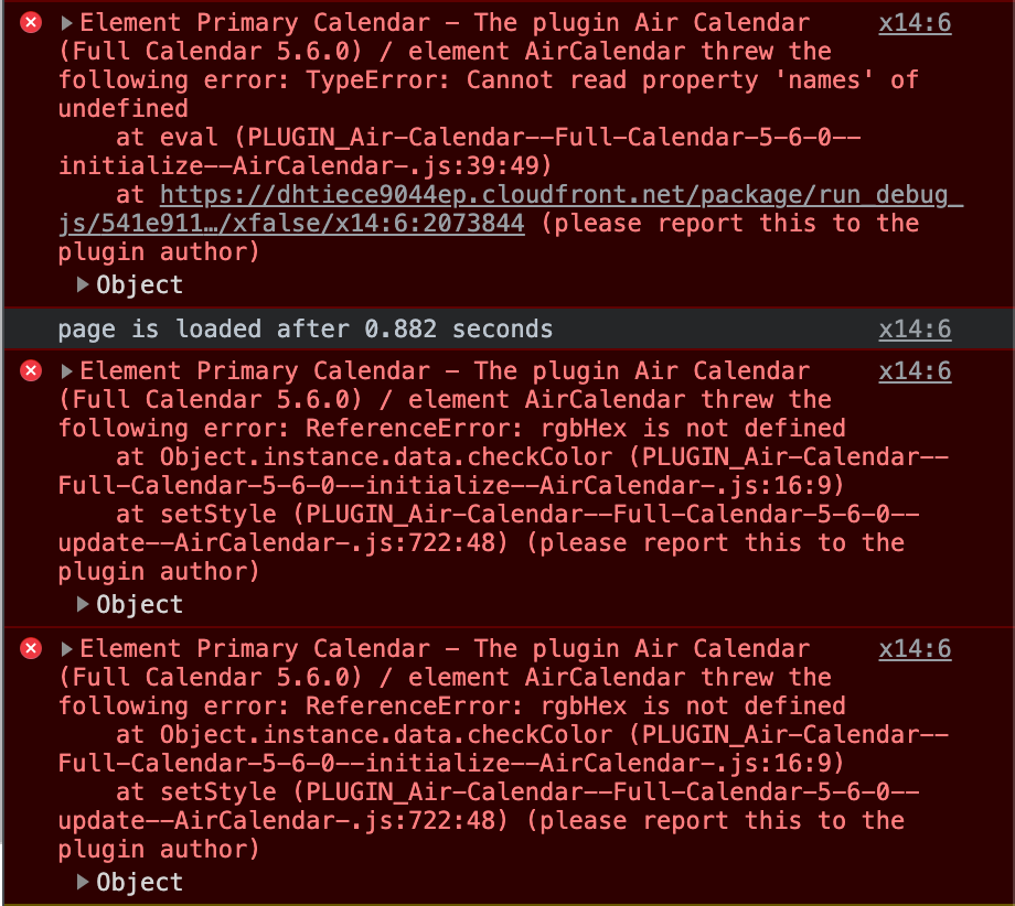

Same here. I receive the same error randomly from time to time (RGB hex not defined). All I do is move the calendar one step to the left or right, or re-center it. This fixes it every time.
Originally I thought maybe it was because a field that I was using for custom colors sometimes was blank depending on the event, so I did a mass change in my database so that no matter what, everything has a color but this did not fix it.
I haven’t reported it because it’s just so random and is fixed by a slight movement so it’s got to be hard to track down.
I will say though, 100% of the time I will check to make sure my calendars are working before deploying to Live, and it’s a 50/50 chance that it will work in Live or break, and then I have to make some type of adjustment and re-deploy to Live and it works again. Very Strange.

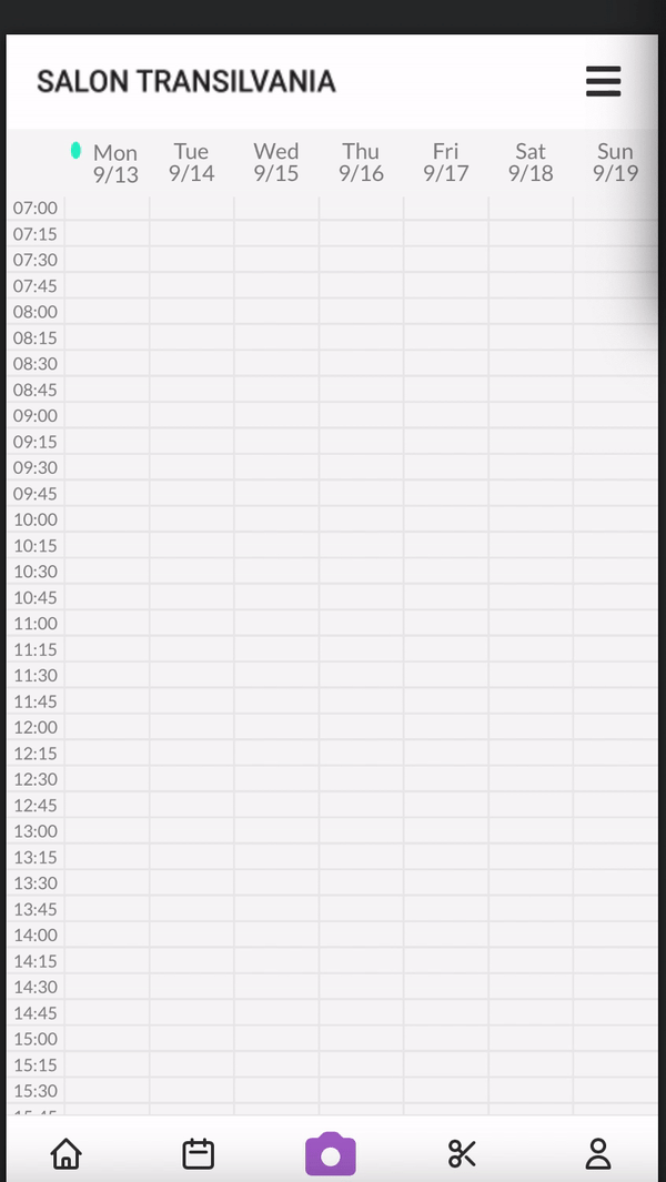

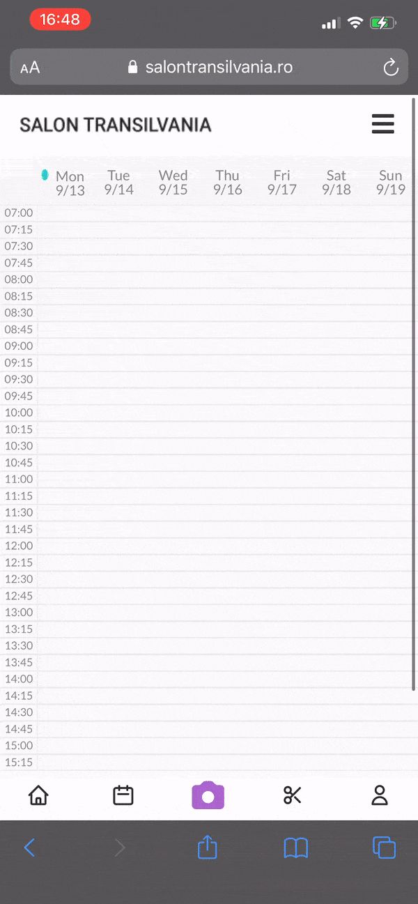

@levon i would like to ask a few more things if possible. I have subscribed to plugin and need the following:
  1. On click or on hover, the vertical calendar lines disapear.
    ezgif.com-video-to-gif
  2. Would it be possible to have the header fixed? check below the strange behaviour
    ezgif.com-optimize
Thank you
Hi @avern87, @christo1, @rpetribu and @bcart0v, thank you very much for your patience and understanding :pray:
We have pushed a Air Calendar plugin update, that has fixed the issue related to intermittent rgbHex error (plugin element crush).
To check changes, please upgrade your plugin to the latest version (Version 2.20.0: reworked additional libraries) and give it a try.
