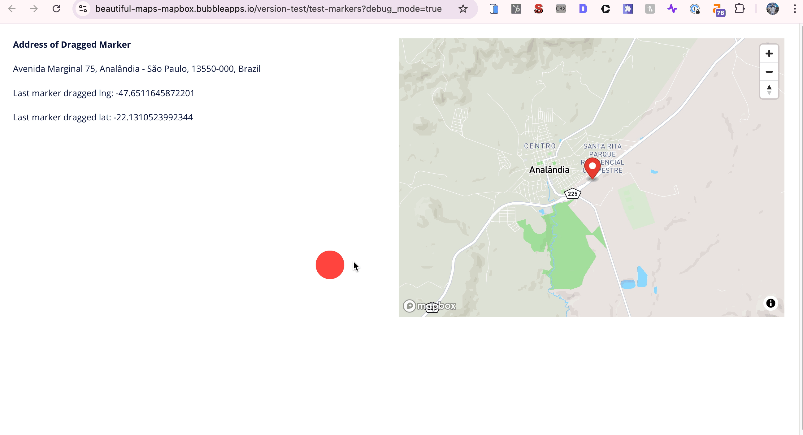

Hey @azarroyodev, I had a look into that issue and I’m afraid I couldn’t recreate it on my side. The API seems to be returning the correct address for me - see below:
2025-05-28 14.31.17
Can you try this out on other addresses and see if you have similar issues?

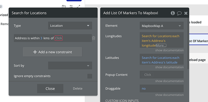

I hope you’re doing well. Would you be so kind as to advise me on how to configure a search that returns all coordinates within a three-kilometer radius of a specified point? Your guidance would be greatly appreciated.
Thank you in advance for your help.
Best regards,
Moby
Hi @goods2map0415, good to hear from you. I’m guessing you want to add markers to the map for each coordinate that’s within the 3km radius of the specified point?
In order to do this you’ll need to save down the geographic address of each location to your database.
Once you’ve done this, you can filter for coordinates that are within 3 kms of a certain address - see below for an example of how to set this up:
You’ll need to use this filter for both the Longitudes and Latitudes fields.
Let me know if that helps :slight_smile:
