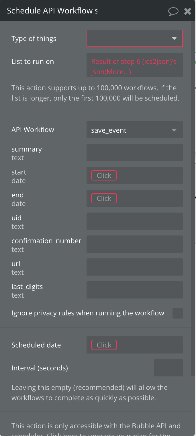

Hey @muneer.hameer I’m trying to use the plugin which looks great but I’m having a problem with a specific use case.
I need to save and sync an Airbnb calendar. My issue is that I’m not able to run the workflow API on the json (ics2json) because Bubble doesn’t recognize the type of things.
How do I let them Bubble know the type of things of the json?
Hi
Couple ways to approach this:
  1. Set up a backend workflow for the ics2json action
  2. Expose that api to public
  3. Set up an API call to that workflow in the API connector (it is sort of circular as you are calling your own backend wf in the api connector)
  4. Call the API and save the response
  5. Then use that API call in your future workflows to obtain and read the json response.
Or
Get a plugin like JSON assistant that will let you work with the json response from the plugin.
Hope this helps.

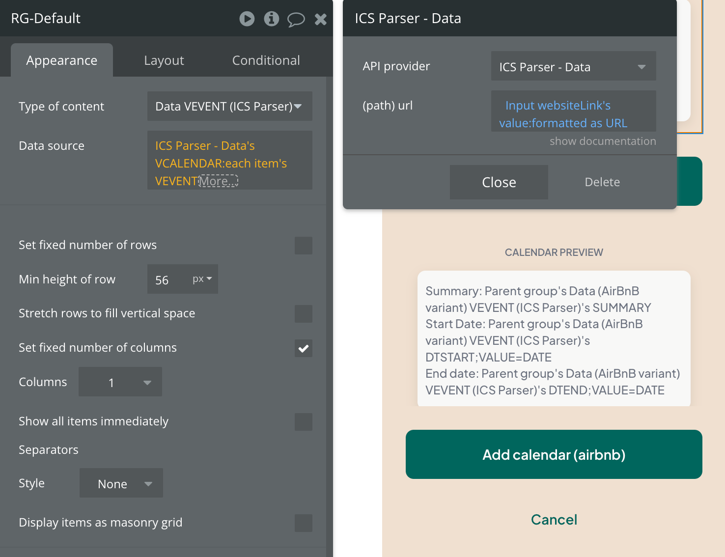

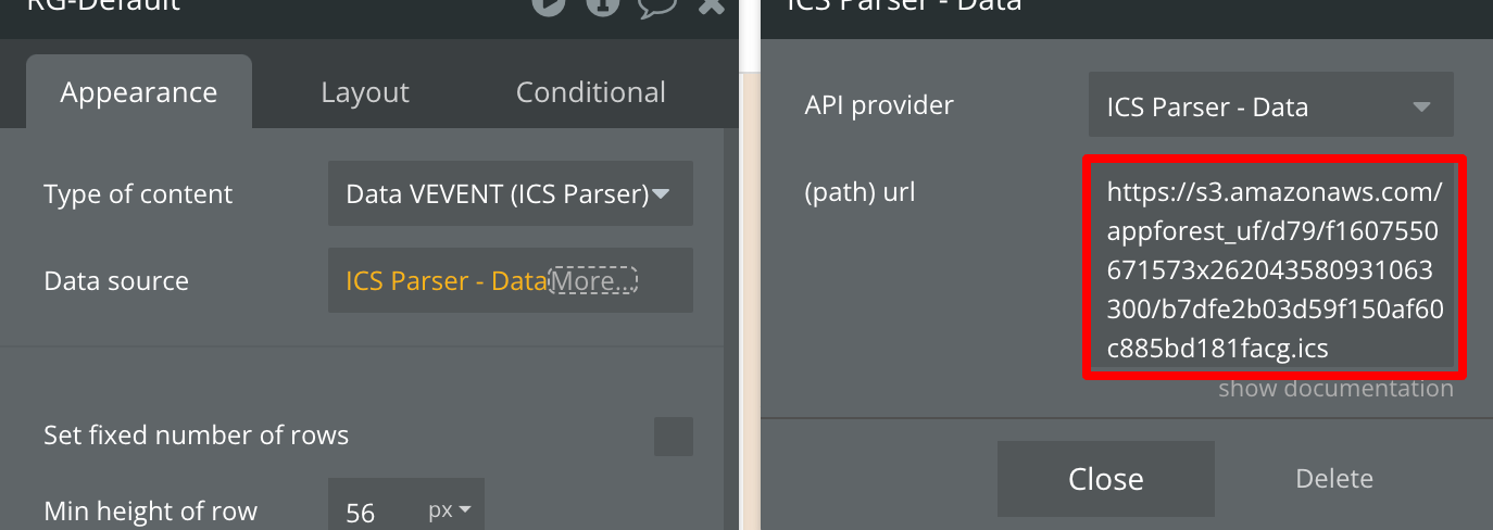

@muneer.hameer I’m currently testing this for Airbnb, Do you have an .ics link for testing?
@muneer.hameer Please remove this from the preset. Even when overwriting with a dynamic input field, the path URL remains the ICS source.
I’m sorry, I don’t have a sample.
I’ll look into your other comment. Those calls have been part of the plugin for a long time and it’s the first time I’m hearing of such an issue. If you are replacing with a dynamic input that’s not empty, not sure why it would reference the preset, unless it’s some bubble bug.
@muneer.hameer the bug is consisntely present on "Data VEEVENT (ICS Parser) and not "Data (AirBnB variant VEEVENT).
When I put any static text in (path) url, it works as expected, however when I put a dynamic input field (the way it should be) the default “s3.amazonaws.com/appforest_uf…” is the data that gets pulled
Hi there, I pushed an update removing those preset urls. Can you update the plugin and let me know if it resolves your issue. This sounds like a bubble bug, not the plugin.
@muneer.hameer that worked! Appreciate the quick resolution!
