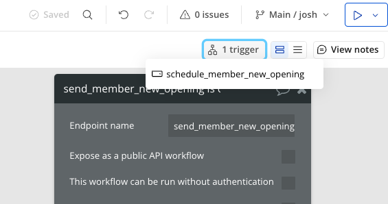

Pro Tip: make sure the property editor isn’t covering up the Triggers menu. That is one of the best features of the new editor and it can be out of sight on page load:
That tells you everywhere that triggers the selected API endpoint or Custom Event, similar to if you did a search for “Schedule API workflow…” but it’s way quicker.
You stole my pro tip. Not cool, dude.
Maybe not appliacable to everyone, but also:
  • Give value to the Triggers section, with info about places where this workflow is triggered. Underrated but extremely useful.

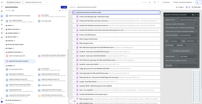

this is how i use it, it’s awesome
