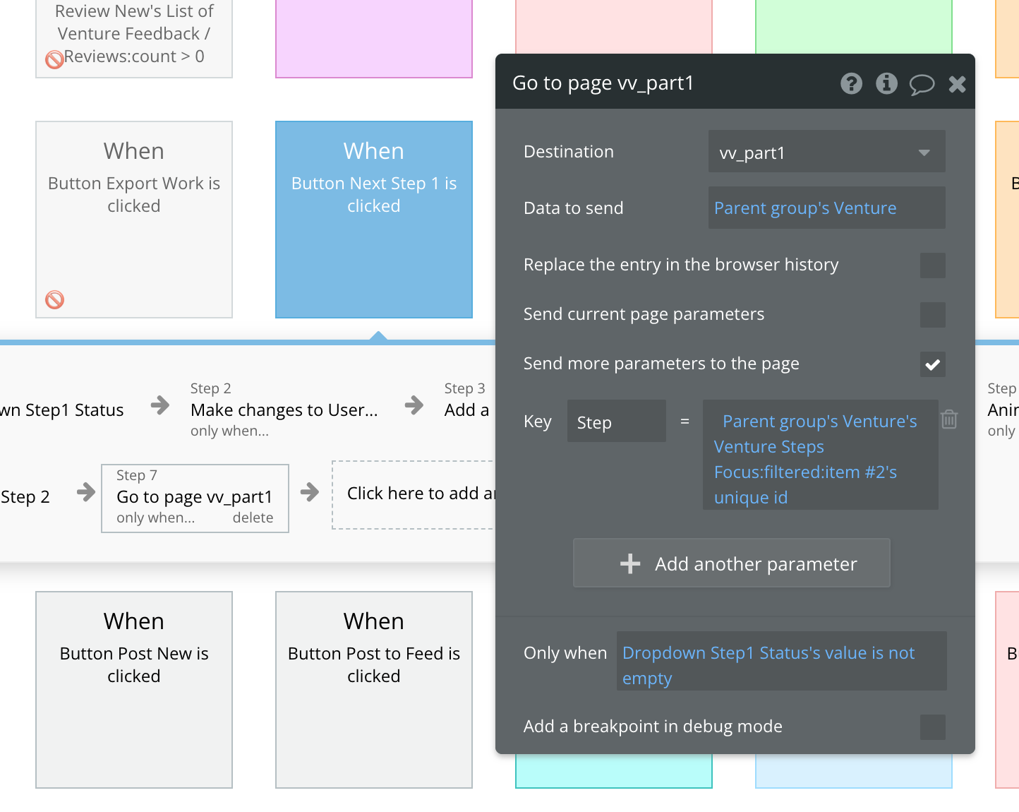

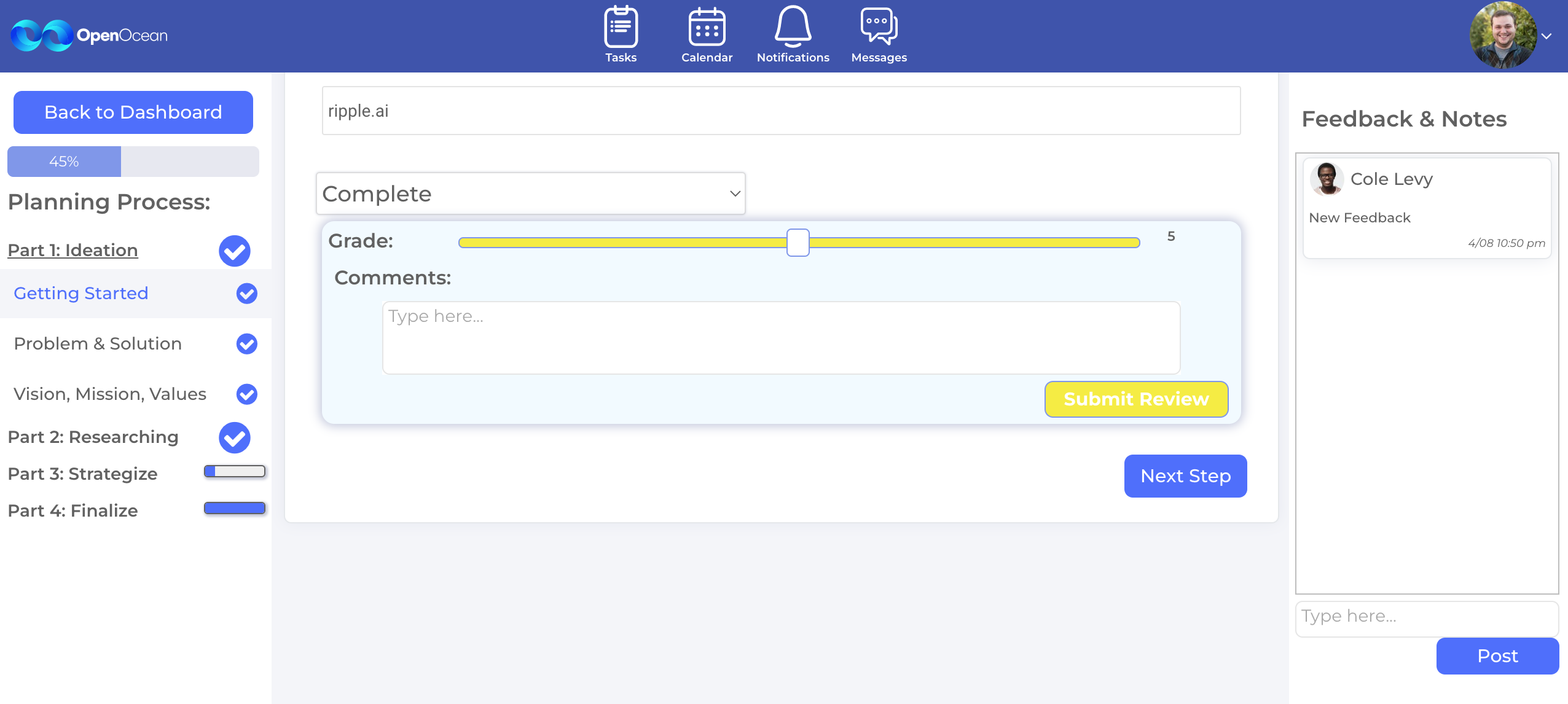

I need only the steps that they have been assigned to show up for them as they go through the process. The main problem is that I have broken up steps into parts, and I can’t figure out how to make the next and back buttons to show the right steps.

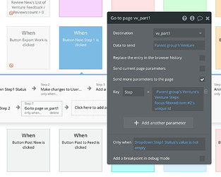

Here are some screenshots that hopefully help? Can also record some videos too.

it looks like it’s a list (I’ll call it a list of steps). You need to store a current step (basically an index number) and then just add 1 to your index when user presses the next arrow. Minus 1 to the index when the user presses previous, etc.
To get to the current indexed step, it’s Venture's list of steps:item #index number
If you’re sending unique IDs to the page URLs, the query is Venture's list of steps: item #index number's unique id
You’ll need a consistent sorting mechanism to make sure each user’s course steps are sorted the same exact way no matter how the page loads.
