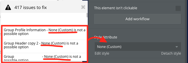

I have recently run into an issue when I copied a page from one part of the app to another and I’m seeing an “Error on None (Custom) Style attribute” message.
I don’t have any style attached to the element from copied page, so I’ve this issue but It would be greate that I can kill 400 issue quickly.
I would really appreciate any guidance on how to quickly mark as solved to this 400 issue on the style attribute.
Screenshot 2566-09-20 at 10.38.16
This should be submitted as a bug report. The issue checker seems to be messed up as the issue checker should flag a style attribute issue is missing only when you have pasted in an element from another app that had a style applied to it, that the app you pasted into does not have in it’s styles tab.
There should be no reason why None(Custom) style is not a possible option as when there are No Styles, that built in None(Custom) is the ONLY option.
Thank you for your comment. I’ll report it as a bug.
I think so, it’s should not check the stuff that don’t have style apply to it, It’s a bit of the pain to just click 400 issue to get it done with out any effective results excepted from marks those error as solved lol.
Did they help you resolve this? Or did you have to fix these 1 by 1? We’re currently facing the same issue after cleaning up a bunch of old styles from our app - we now have over 700 instances of this None (custom) is not a possible option “issue”.
