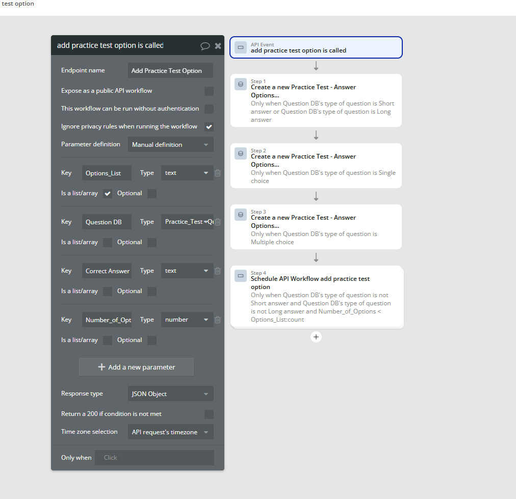

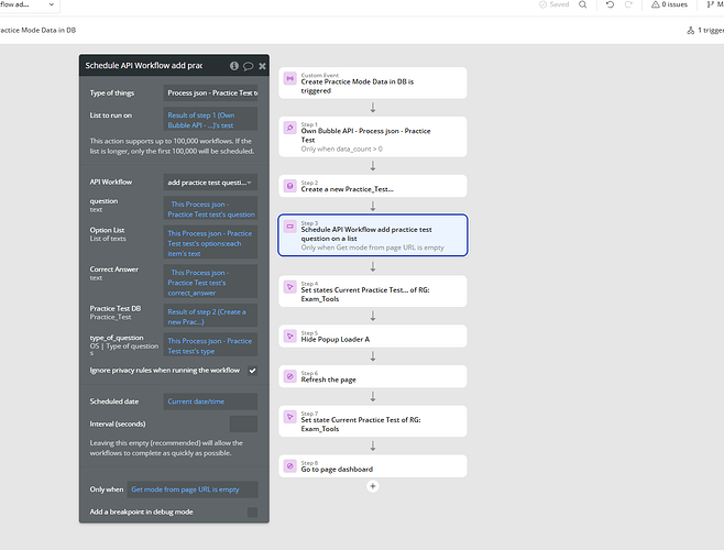

Yes, sure:
  1. New questions are created here using “Schedule API workflow on a list.”
  2. Immediately after that, I attach 4 answer options to each question.
  3. I wanted to somehow detect when all the questions have been created, and only after that display the repeating group.
    But I don’t know how I can determine that.
  4. Right after the “Schedule API workflow on a list”, I even do a page refresh to make sure that all the questions will appear in the repeating group.
    But sometimes, not all the questions are displayed.
How can I fix this?
From your screenshot, I don’t see why you could have racing issue (that mostly happen with field of type list and make change to a thing or when calling an API inside the backend WF that could lead to too many request on a short time on this API).
There’s a lot of conditionnal and steps, so it could be hard to check. Check your app logs, that could help you find if one condition is not met for a question.
Try to add a 2 seconds delay to know if this is the issue, but if this is the case, I would raise a support ticket as there’s no reason from what I see in your settings to have racing issue
