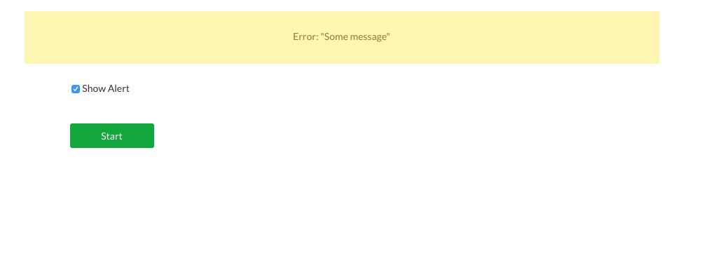

I have a simple page with three elements on it (Checkbox, Button and Alert):

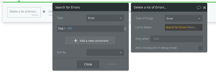

And one workflow:
At the first step I clean up database by deleting all records with simple condition:

  1. Opt in Checkbox
  2. Click Button Start
  3. See the expected result:

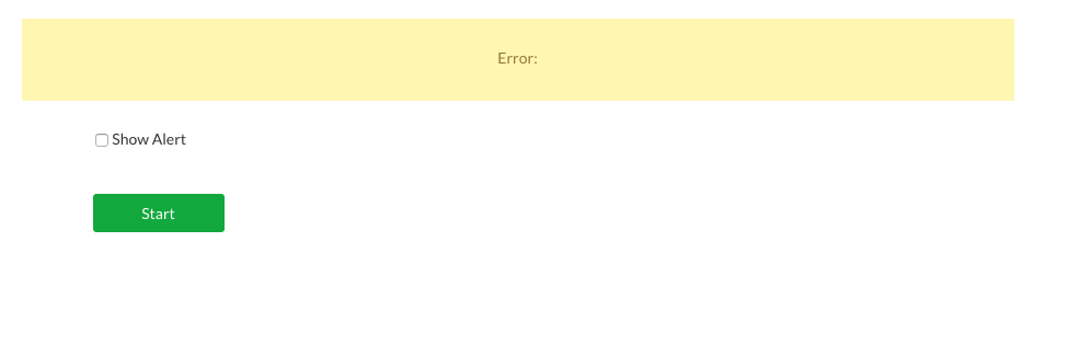

  4. Opt out Checkbox
  5. Click Button Start
  6. See unexpected result:

@stavvit, the 3 actions in your workflow don’t necessarily get processed in that order within bubble. I know the UI makes it look that way, but they process the actions in parallel as much as possible (which is much better for performance reasons).
Note - there’s 1 way t o override them all running in parallel. Here’s how it work: if action #2 used “results of step #1” then it’ll wait to run action 2 until after action 1 completes. Otherwise, they’ll run in parallel.
This could be the problem you’re seeing.
