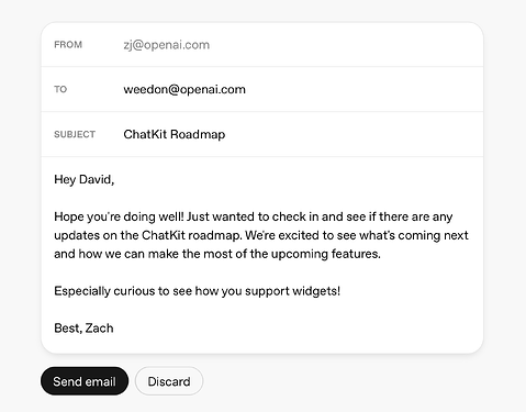

For example, the image below is one of the example widgets that OpenAI provides when integrating into your agent workflow.
Now, I have no issues with the agents extracting data from my bubble application (I primarily rely on Vector Stores + Google Drive MCP). So for the example widget above, it has no issue filling the from/to emails and the subject/body.

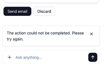

My challenge is registering when a button is pressed. Currently, when I press “send email” inside my bubble embedded chatkit, I get an error inside the chat “An error has occurred. Please try again later.” Outside, within the browser console they flag CORS policy and invalid GET URL. (I have spent hours going back and forth trying to resolve this and cannot figure out what is causing it.)
