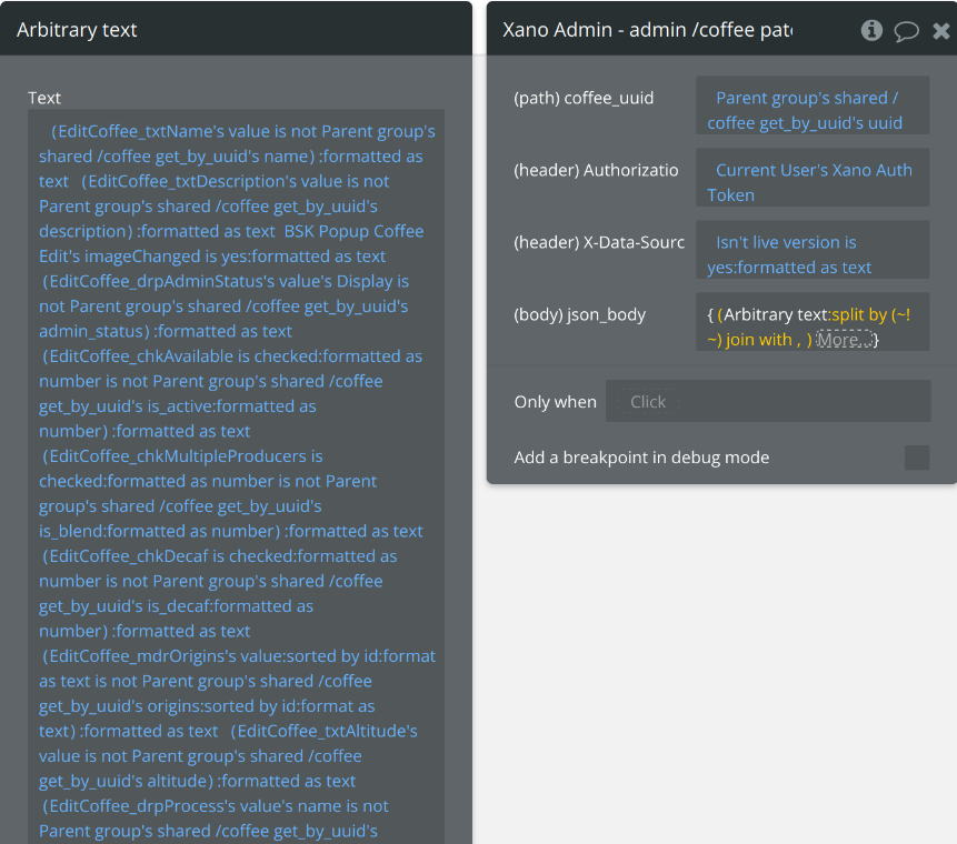

Agree, it would be fairly easy (there are already client-side versions in my Xano plugin, so it’s definitely doable) - the main annoyance is that the bubble plugins don’t have dynamic properties, so it would pretty much be no different from the solution you suggested above - just passing a JSON slab of text to the connector. You could always pass the parameters as a list - but the effort building that list in the first place is probably just as annoying as a slab of JSON…
Anyway, the “slab of JSON” approach works perfectly, but it’s going to be truly chaotic evil to debug this if I ever need to troubleshoot it (almost certain!):
