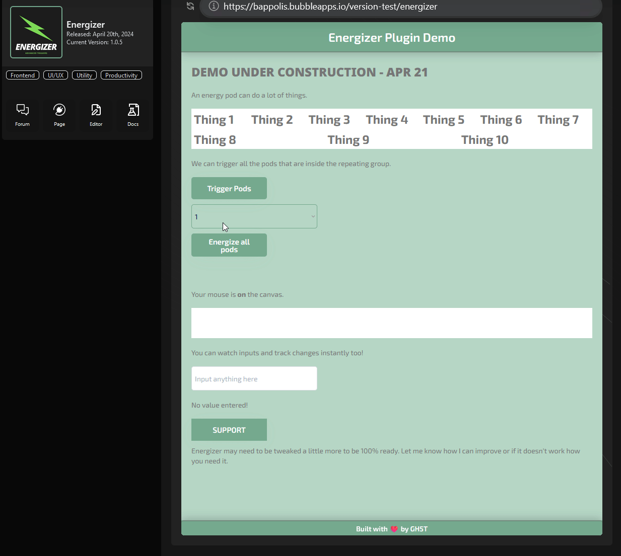

The demo pretty much shows everything it does.
ZHBAPjDhmW
I’m sure there is quite more logic that can be made with it, but it’s essentially a RG popper. I may need to tweak/work on it a little more.
