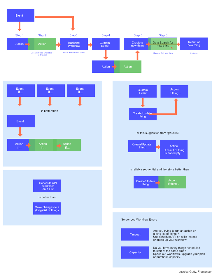

For anyone who is a visual learner like myself, here is a visual workflow guide I did of the reply from Bubble Support. Any additions or changes you wish to make let me know and I can update it.
*updated June 5 to include @austin3’s suggestion

One thing I should point out though is that I have been able to consistently and reliably use the “Result of step X” in my workflows to enforce sequentialness when it is needed. @crathbun from my experience you can in fact put this anywhere in the action. You seem to even be able to just throw a “if result of step x is not empty” into the conditional tab to force it to wait, even if you don’t use the result.
@cowontherun thank you for the graphic. For those who are visually minded and are struggling with this, I’d recommend mapping out your workflows in a similar way, with lines indicating workflows that are dependent. Many workflows that seem sequential actually only require 1 or 2 sequential steps, and having the rest run in parallel makes them much faster.

I agree. I think the UI utterly fails to convey how things actually work. Execution seems to follow more of a “data-flow” or “data-driven” approach, but one would never intuit that from the current UI design.

I hope the Bubble team can make workflows display just like the visual document that @cowontherun shared. That would clarify this for new and experienced users. Also would be good to show “the result of” as a step. Ideally the whole inspector could have a setting to expand to full screen as well since both reading and writing complex expressions in those little boxes can be challenging to see and understand what is actually going on.
