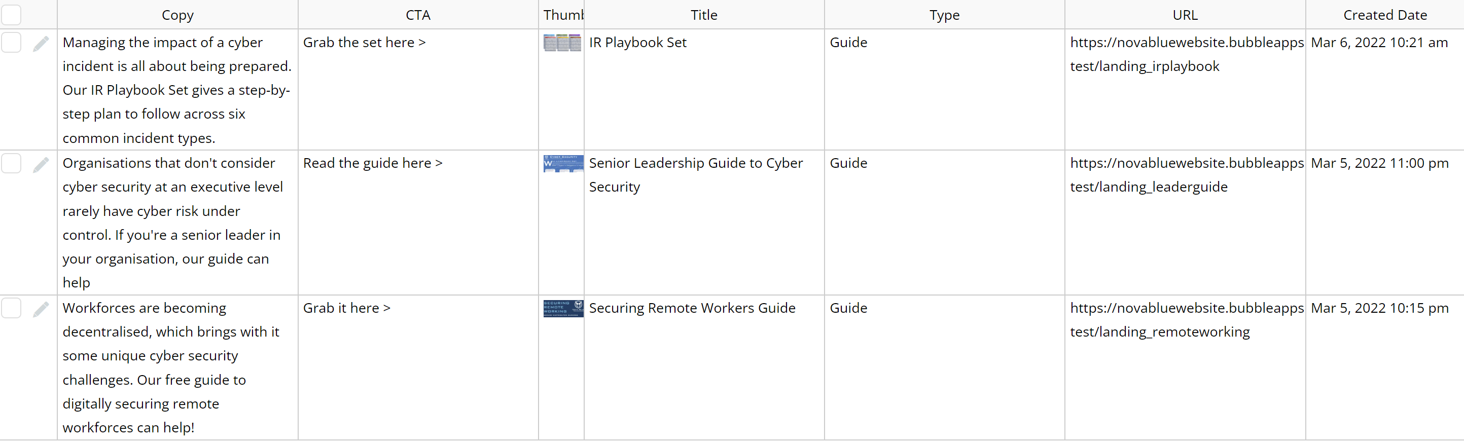

…you can see that the resource cards each have a CTA such as “watch the video here >”. The database has a CTA field (used to populate the text) and a “link” field (that I use to link to a page).
I’ve then built a workflow that when clicked goes to that URL. The problem is that I’ve had to hard-code the URL, and when I deploy to prod, the links won’t work any more…

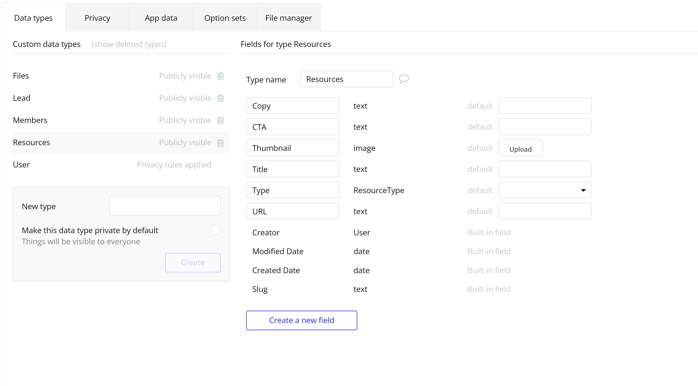

Not quite. Check out the data table:
The “URL” field is currently pointing to the “test” environment. When I deploy to live, this URL will still…oh wait…

Right, I understand now…
So from the screenshot it’s clear your ‘link’ fields are not linking to dynamic pages (as I assumed they were)…
So the solution is simple…
As I said in my first reply, if you use WebsiteHomeURL/Page-name it will automatically refer to whichever version of your app you’re in - so instead of saving the entire URL in your URL field, just store the page name as a text (i.e. “landing_leaderguide”).
Then just use Website Home URL: current cell's URL as the destination URL in your workflow (note: the ‘Website Home URL’ includes a trailing slash, so don’t include another one).
