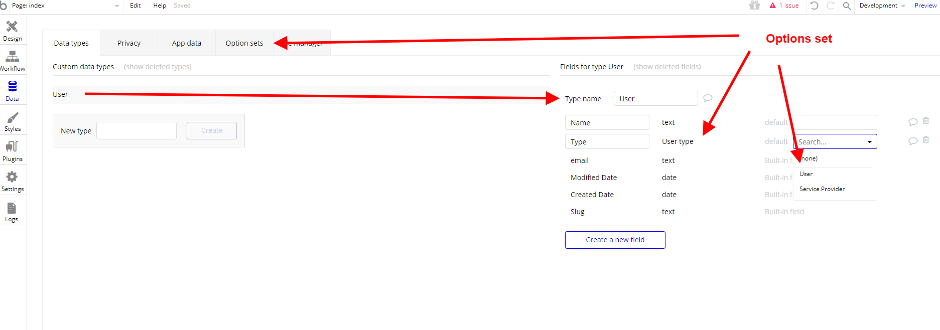

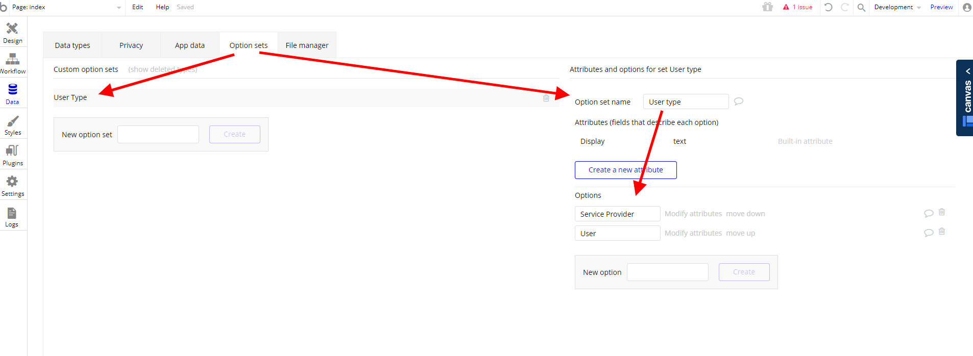

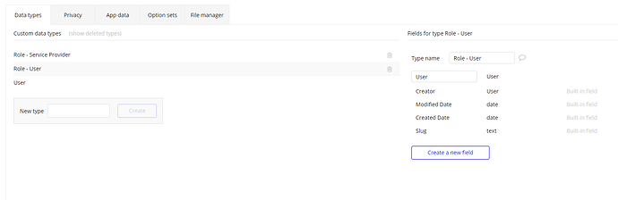

Let me guess how you are structuring your data. Please confirm or comment:
No, this is not how I have it set up for some reason I cannot post pictures here anymore. I have User and Service providers under the first Tab labelled Data Types.
I also have Service providers under the user data type as well.
Noted.

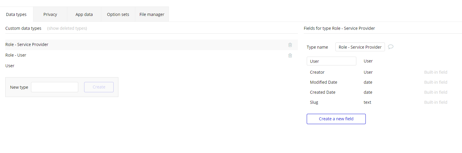

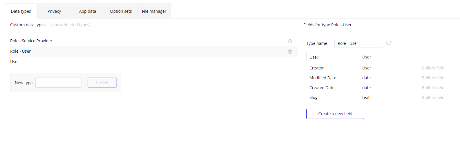

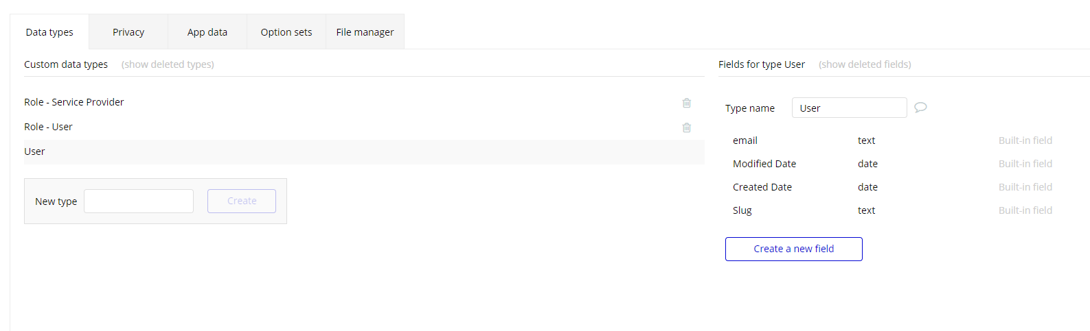

Perhaps things could become much more clear in your thought process with a database structure like this:

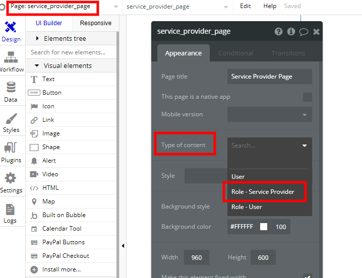

This way you can define the following pages:
The key takeaways from the above structure are the following:
  1. You can use the default data type USER that comes with every Bubble app to manage your users. No matter how they are classified/categorized in your app.
  2. You can use your SERVICE PROVIDERS as you need them and always have a user associated to them.
  3. You can use your USERS as you need them and always have a “true” user associated to them.
Hope this helps :+1:t2:
