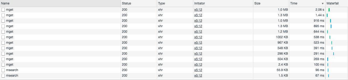

Did you mean to share a read-only copy of your application editor? I wasn’t able to access it but took a quick look at the “it follows” page and the main thing I’m seeing is a lot of these large sets of data that are being downloaded from Bubble:
What that usually means is that your data sources/searches aren’t optimized and Bubble has to download a lot of data to the browser first in order to be able to be able to perform some operation that’s requested of it.

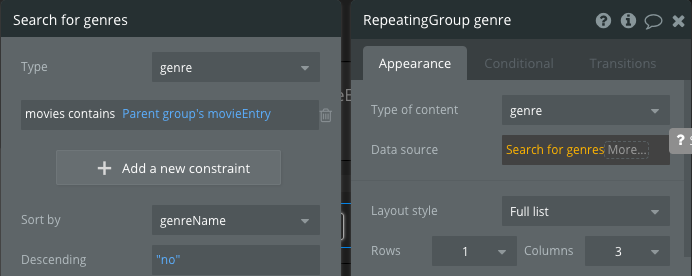

  1. Where you want to display movie genres you’re searching for “genres” where a field called “movies” (a looooong list) contains the movie on the page. Instead, try doing the opposite - have a field called “genres” on the “movie” object and just refer to “this page’s movie’s genres”

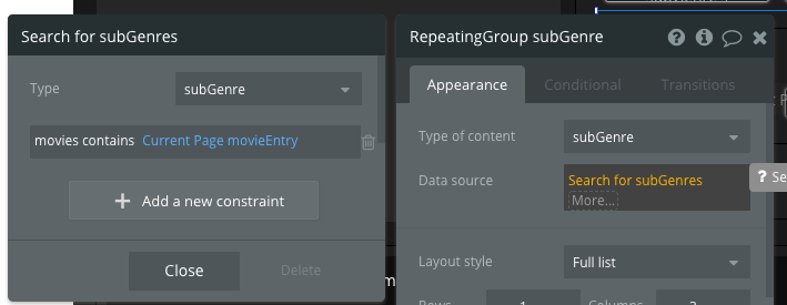

  2. Same as above for subgenres

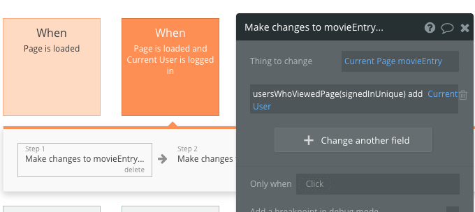

  3. I would change a “page view” to be a separate object instead of a field that’s stored on the movie

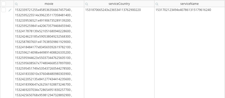

  4. Also instead of having a single MovieAvailability object that stores the list of movies available for a particular service country and name combination, I would try to have a single MovieAvailability object that stores each service country and name combination and then have a field on the Movie object that’s a list of MovieAvailabilities (it’s likely to be a much smaller list)
