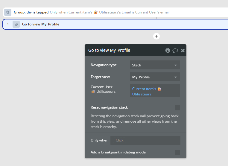

Add a new propety to your view and assign whatever type of object you wanna pass through it and voila, it’s documented here : Open Doc
Thanks, that I was aware of but I can only reference the current view. If I want to pass data from one view to another how do I do that?
If you create the property, then you can pass data through it from the actions, something like this :
i hope this helps
Thanks, yes that helps. I don’t know why I didn’t see that before. Thanks again!
