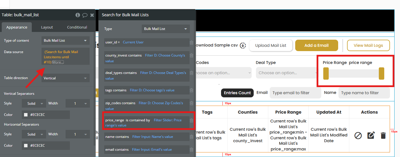

I have set up a filter for approximately 75,000 records, which includes filters for list values and a number range. When there are fewer than 500 records, the number range filter works fine. However, with the full dataset of 75,000 records, it takes 3-5 minutes to load, even if I set the display item limit to 10. When I remove the number range filter, the results appear in 1-3 seconds. What am I doing wrong here? is there any other options to do number range filter for number range values.

Hi, thank you for the reply
I never show everything. check the images I only get 10 items as limit(item until #10).
I tried by separated params like you said
Same issue. it took 2-3min to load 10 records.

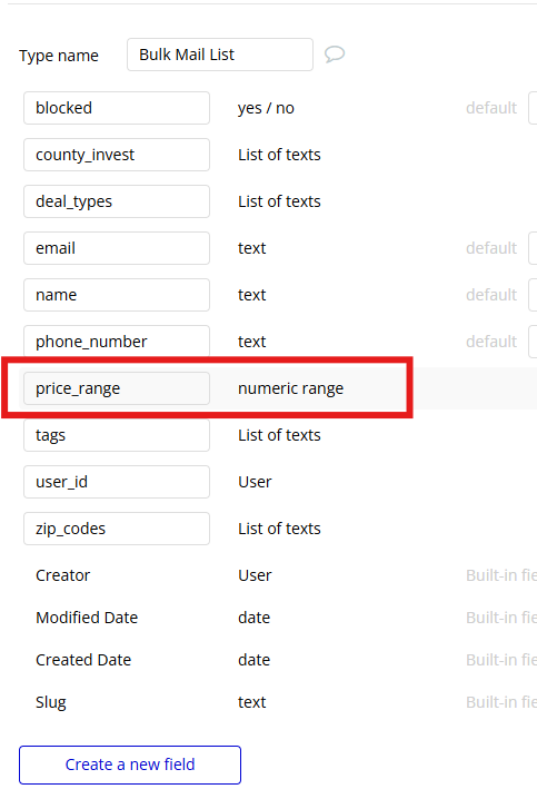

Even if you choose to limit to 10, the search will first pass all db rows to check constrains, that s why I suppose it is so long to display.
I never used the range field. But I suggest to store a max and min price instead, it will be quicker to render.
