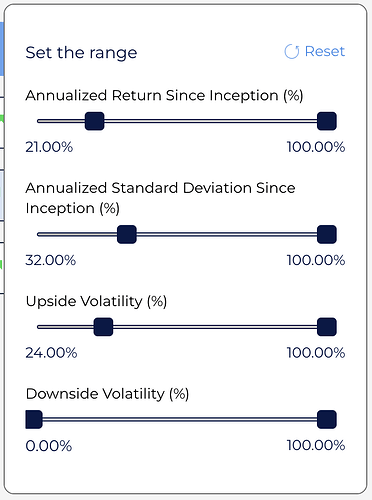

Recently, we’ve implemented a sets of four advance filters that let user find a list of funds based on four criteria ranges (see figure below):
The four advance filters that
The user experience I want to give is as the user changes the range of the various filters, the list of funds will automatically get filtered out.

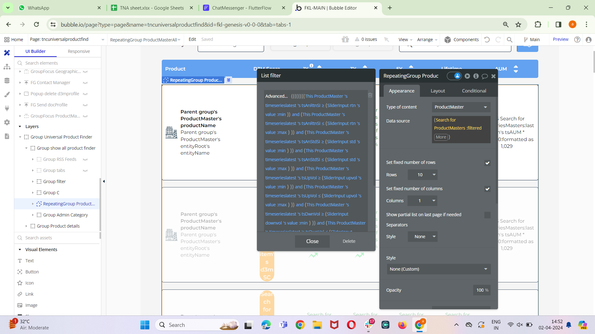

Also screenshot your actual data source and what your searches/constraints/filters look like too. Using search constraints is different from adding :filtered to the end of a search

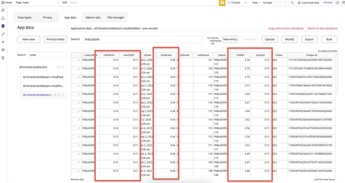

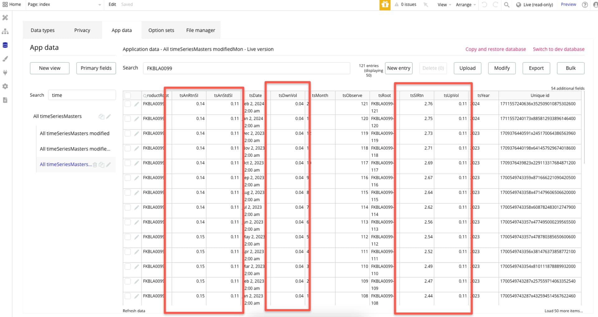

Here is the screen shot of the data source. This is for one single fund and the red frame are the four data fields which the filters are built on.
Below is the search constraints that are applied to the slider
Yea that is your problem. What are you constraints directly on your search? (Not the filter after the search)
Those look like they can easily be individual search constraints just stacked ontop of each other. Those are performed serverside during the search process so they are very quick.
Right now you have a filter clientside so its probably downloading the entire database then filtering after :joy:
