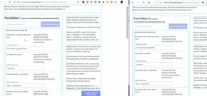

@kramwe there is an active relationship between objects you display in a page (more correctly: objects you reference in the page – they need not be displayed) and their state in the database. If you are on a page viewing info about user johndoe@example.com and John elsewhere updates his information or some process updates his information, you will see it change in your browser.
I don’t think these page elements are continually polling for changes. Rather, Bubble knows about this session and is actively sending info when it changes. (But I could be wrong - I don’t know the exact mechanism used here.)
(ALSO, that a page has a type says NOTHING about whether information is changing. It sounds to me like you’re assuming that viewing a page of type User changes something. Nothing changes unless your app takes action to change data. Conversely… if you are displaying a Thing and the Thing changes, YOU WILL SEE IT CHANGE… in most cases.)
As for your question about “persistent record types on page synced with the dB”… Your page doesn’t need a type for you to pull any data you want. You could have any number of groups on a page whose datasources and types are different. Any group, RG, or text element, etc. that uses a Search as a source for something displayed will update as underlying data changes.
If you want to see – in realtime – what is going on with Sessions in your dB… Just display the Sessions! They will magically change right before your eyes.
NOW, there are ways of disconnecting things (in the example I point to below, look at the lower right text area – I source a list of things via a custom state there so the list size is fixed, but the fields on the individual data objects displayed in that list will still reflect changes).
You can play around with this in this example app that took me a few minutes to build. Open two different browsers or browser sessions and make some changes to the Foos displayed here… watch them change in the OTHER session at nearly the same time:
So much easier to show than tell (and I can’t imagine why you’ve never noticed that this is, in fact, the way things work) – go look:
Check out the example below. This is exactly the same as when you have an admin page like this – check out runmode first and then look at the editor – this shows/explains what you’re curious about:
Run mode:
Editor (anyone can view):
Are you sure you’re doing anything that Bubble wouldn’t do for you automagically? (It doesn’t sound to me like you’re “syncing” anything. You’re refreshing a display. )
Note that, in my dopey example app, anybody can come along and delete a Foo if the Foo is more than 2 minutes old. And anyone can edit a Foo’s name at any time. So the user on the right (in my spoopy GIF) can delete a Foo that the user on the left is trying to edit. (In the first video… but note that I did a change…)
Do we care? Not in this case. You of course could take measures to ensure stuff like this doesn’t happen in your app. (In the usual ways - like making it so only the Thing’s creator can modify it, via privacy rules and workflows that can only be executed by the Creator, etc.)
Can an API Workflow be updating some thing while the Creator might pop by to edit it? Sure, but of course we can handle that (set a field on the Thing “I’m being updated” - don’t let anybody else change it when that is true).
Even so: Can database collisions still happen? Prolly. But not in most cases.

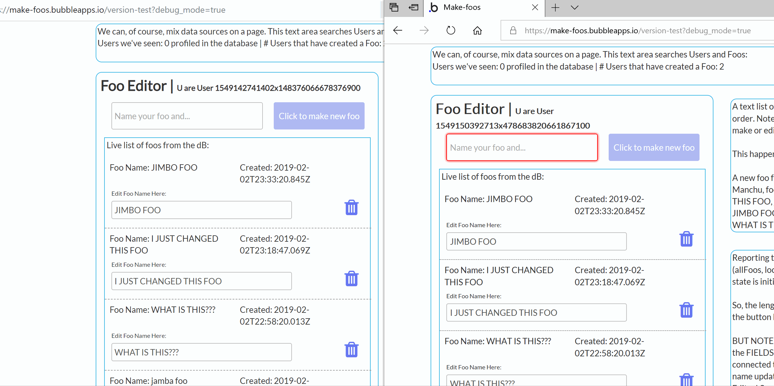

My net net point: There’s no “client side” record versus a dB record. Shtuff only changes in the dB when your app tells it to!
And… Even so, ways to prevent collisions are easy to implement. Since I hadn’t played with it in a while I just went and added that weird trick with reusables (where you can make them run workflows from inside a repeating group) to the sample project.
Now, when a user clicks in an edit field in the Foo Editor, a workflow runs that “locks” that Foo from editing. (It’s not really “locked”, right? – this state just tells the Foo Editors that might be running in other sessions to disable the edit field and display a little “lock” icon. This is how we do it.)
Since those users have nothing to select, they can’t edit the item. It’s super hinky and of course you can’t run API Workflows in a free project (which you’d need to really manage such a system properly), but even then you can do weird workarounds like this project does (e.g., when the page loads, we run “Make Changes” workflow to clean up any “locked” Foos that might not have gotten unlocked – e.g., the user’s session could end while they were inside the input and so the workflow might never run to unlock the Foo… so we just check for Foos that have a lock expiry that is now in the past and unlock them).
Here’s how that looks:

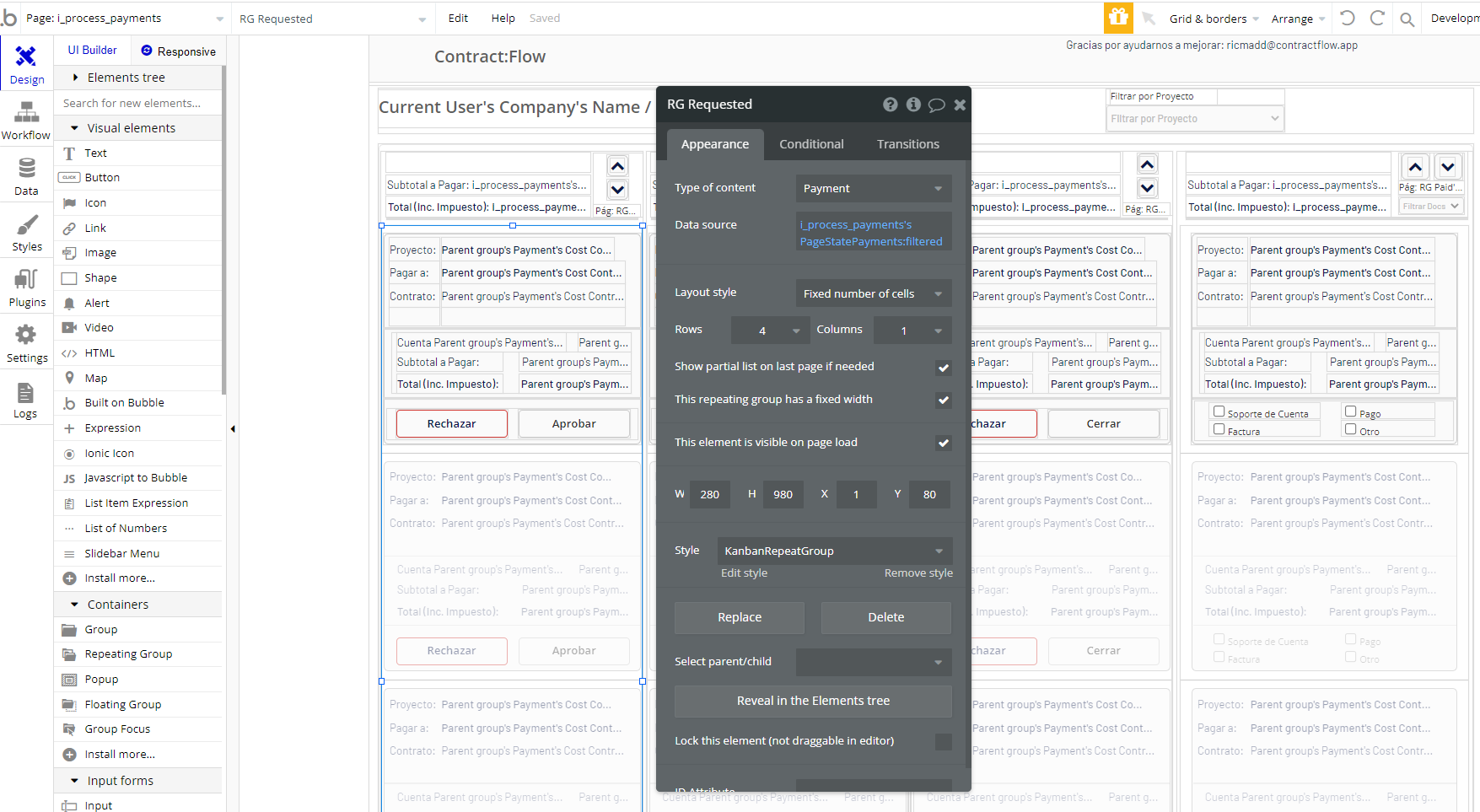

I have a simple set of lanes (phases) in an OptionSet
I load “cards” in to show on these lanes.
I have only 20 items in here and at first it took 45 seconds to load. (no img)
Optimised, got rid of filters all solved in Search now. It’s loading in 14 seconds. A lot faster but still slow.
It seems to hang on requisition the OptionSets which has no search what soever on it. The RG loads super fast without the lanes. Any data known on user optionsets vs tables?
A search based on an option set should be instantaneous. If you provide some screenshots/description of your data and search setups, someone may be able to help you.
3 minutes.
I show the page I’m loading. You see it hanging (this time on 2 google analytics calls). Then the rest loads.
Then I go into the builder,… and show the 2 RG’s and their conditions.
Hmm… if it’s google analytics hanging, that’s beyond me since I don’t use it. I’d suggest trying to test a version of the app without Google analytics in there and see how it runs.
Re: your setup generally…
  • Good that you are avoiding a “:filter”
  • I see you have a nested search (search occurring within a search) – that adds time
  • Looks like you have a horizontal RG. I notice at the bottom of each cell there are stats for Stakeholders, Startups and Talk – if those are searches or calculated values (rather than values already set in the datatype) then that’s adding time of course
  • In addition to google analytics hanging, it looks like it takes a few seconds to draw your page, I am assuming due to: a) having a lot of elements and functionality on the page; and/or b) the page having to do a lot of searches from the database in order to start displaying; and/or c) a crappy plugin that’s slowing something down
I’m not an expert by any sense, but my simplistic approach would be remove something and see how it runs, then put that thing back and remove something else and test again until you isolate the issue(s).
The book on performance by @petter is worth reading.
Perhaps someone else on the forum may be able to spot the issue.
Thanks @ed727 much appreciated!
I think you are right to just rebuild the page and see where the time comes from.
I just received another suggestion. Loading the data in a separate object on the page. Then using that one to populate the RG-like structure with show/hide properties. Since this board will never have more than 20 cards on them,…
Indeed each card does have lookups / counts,… each of them is about a second. So much to win there too!
Good luck – my guess is it’s either google analytics or the nested search slowing it down, or perhaps both. I forgot to ask whether you are using a scrolling RG, but that can help limit the amount of searches/data called at page load and make things faster. Please post the solution so we’re aware of what to look out for!
(On preloading the data, I tested it, but it had more downsides than upsides for my particular app. If too much data is loaded, that slows the initial page load and also can bog down or crash the browser.)

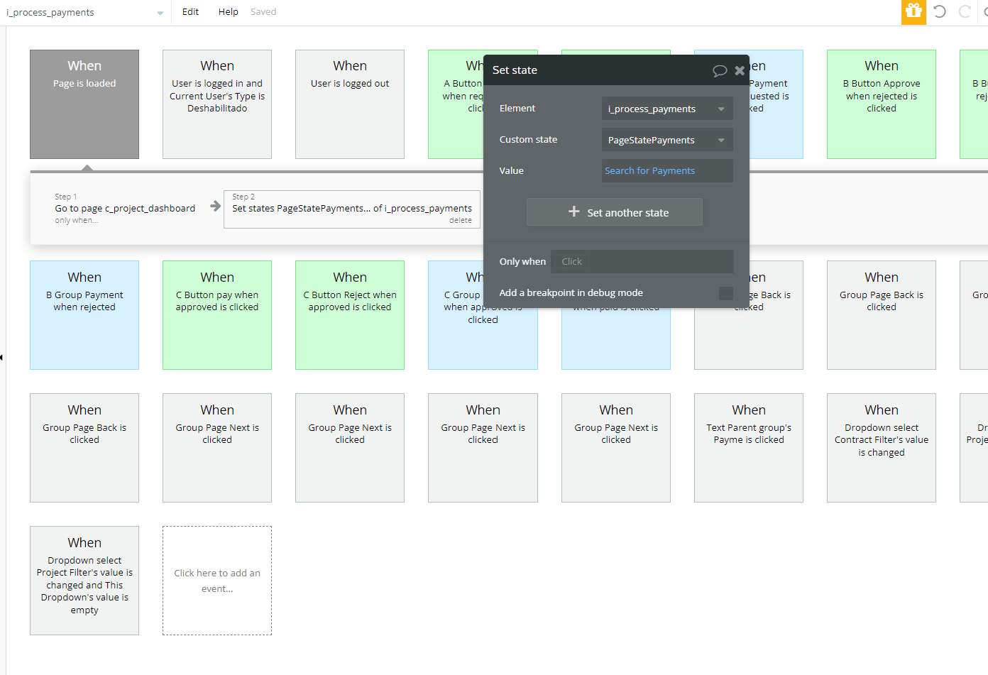

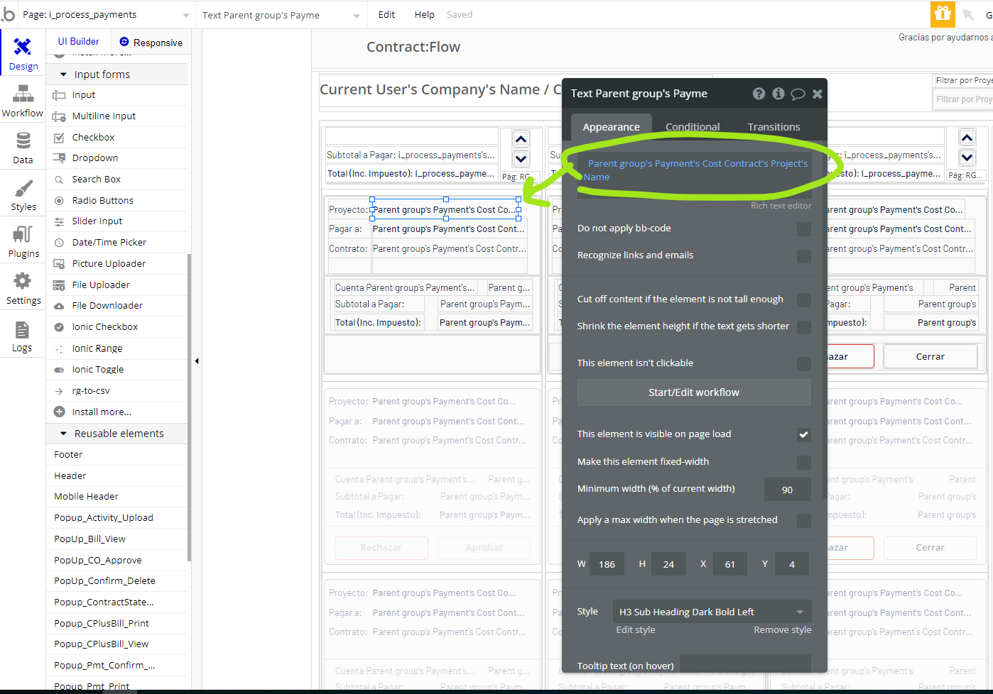

My structure has Projects, which have Contracts, which have Payments.
On the main page of my webapp I display all Payments in four different Repeating Groups, filtered by their Status. To do this, I search for them on page load and set them as a State on the page. That works well.
When the page is rendered, however, I use various Text elements to display different details about each payment. For example, I show each Payment’s Contract’s Project’s Name.
My main user is approaching 1000 Payments, and displaying these text element takes a long time (30 secs) for them. I assume because, once it loads all the payments, then it’s searching to get the details of each one. I have added pagination so that only 16 payments are displayed at a time. This did not help.
Any suggestions? Would there be a way to get each Payments details on another search when page is loaded, and then tell each text element to get the Payment’s Contract’s Project’s Name from there, instead of having to search again from scratch?
Thanks for any comments you could share!
Search for Payments on page load:
Payments displayed in Repeating Groups:
This is where it gets slow, when it has to get each Payment’s Contract’s Project’s Name:
In database design, there is something called “normalization”. Typically, you never repeat the same piece of information in 2 different tables in a database … Most relational models will encourage you to do this. You can look up “Boyce-Codd” if interested.
But when performance matters, sometimes the easiest way around is to duplicate a column’s value into another table. That is called “denormalization”.
