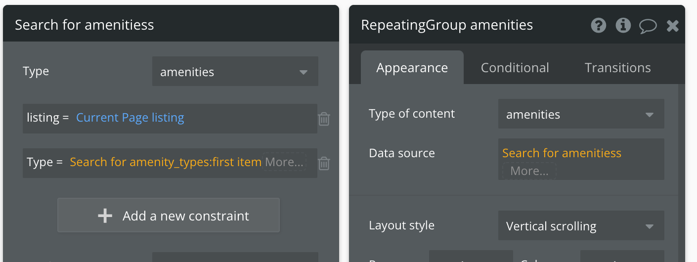

@daniels.korens your data structure isn’t configured in the way I understood from your original post. I’ve modified the search based on how you have your database is set up. Have a look now.
@alex.esposito.1108 this is perfect!!! Thank you so much!
I will post a solution underneath for everyone else to be able to use it -
