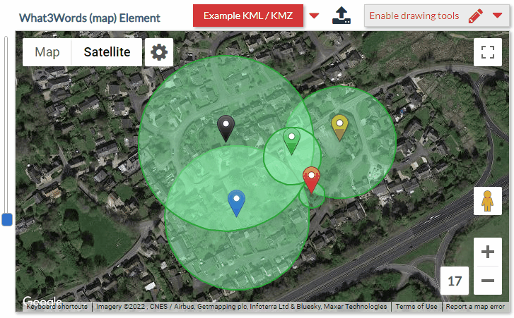

Circles around markers + animation options
This update provides a way to draw circles around markers to outline any given radius in a specified metric. The circles include a bunch of options, and they can be animated as shown below. Although, due to the nature of the animation, I don’t recommend enabling it on a large list of markers. These animated GIFS don’t really do the animations any favours but if you go to the demo site and try it, you’ll notice it’s a lot smoother.
Within the 2 marker actions are a bunch of new options. For documentation purposes, I’ve outlined these options below which are for the Set marker action. There’s a similar set inside the Set list of markers action also where the presence of a Radius field in whatever table you define as the dataset will replace the “Draw circle” option.
