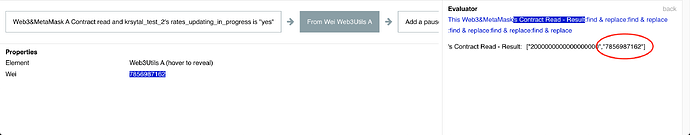

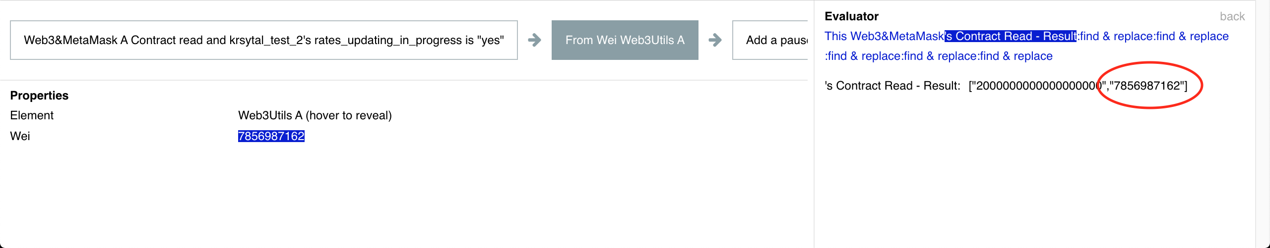

thanks , BSC works well but when changing to ETH with its uniswapV2 router address i returns incorrect values from wei results like in the image , you know what could be the issue ?
Hard to say without the proper context, but from and to Wei works as expected on any chain, you can test it here
