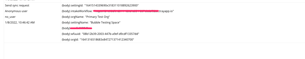

Here’s a log of the data appearing to be sent:
However when i look at the logs of the request in the external service, no data appears in the body, it’s just an empty string.
