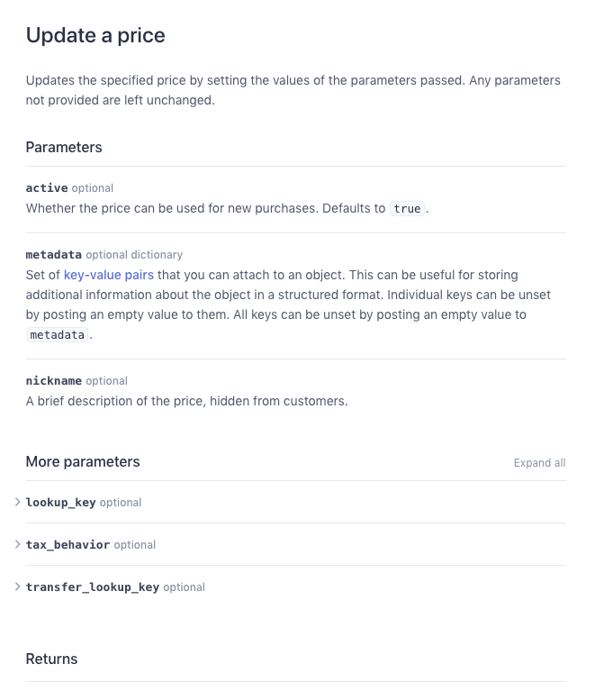

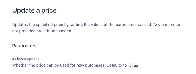

Same thing here. I have trying to update a price from a Stripe product through Bubble API Connector. The only parameter works is meta but it doesn’t actually change the price and interval, for example. Got also the unknown parameter errors. :cry: Do you have any idea what other parameter would possibly work ? Thanks.
Metadata is not something that Stripe will use to process any data. It is something that will be attached to the object for your use, like when processing in the backend on a webhook, but Stripe does nothing with it in their database.
To change the price, you can only create a new price and attach it to the product…one product can have multiple prices attached to it…if you want to remove a price, you can’t delete it, can only make it ‘archived’.
I managed to “delete” a price but not able to update the price. I’ll take a look to make it “archived”. Thanks.
There is not a way with the Stripe API to delete a price. You can however, manually inside of the Stripe dashboard delete a price so long as it has never been associated with any purchase.
Screen Shot 2022-04-17 at 1.00.19 PM
Screen Shot 2022-04-17 at 1.00.06 PM
When updating a price you can not change the price or interval, but can only change the parameters listed in screen shot below
So, what you do is update the price to active=false (‘archived’) and then create a new price with the new settings you want to change it to.
