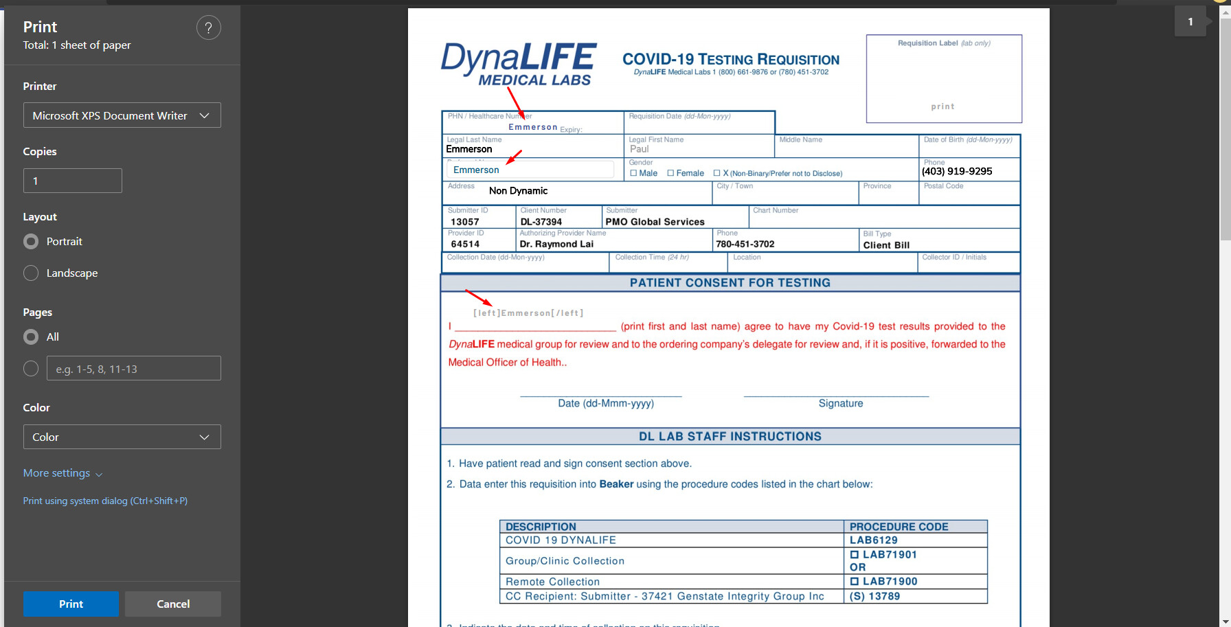

I’m having similar issues in that I can’t get dynamic data to print. Here is how the page looks on the screen.
When it prints, though…
Only the non-dynamic button text prints. Any suggestions?
I’ve made your agency a collaborator on my site. Thanks!

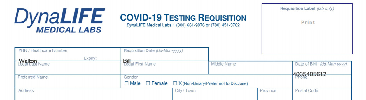

Absolutely! We’re much closer now. Can you help me figure out how to not have the dynamic text drift from page to page? It looks fine on the webpage, but when you print, the dynamic text fields drift up and up more with each page:
Page 2 webpage:
Page 2 Print:
It just gets worse from page to page. Actually - any guidance you can give on how to format the webpage so it will print correctly would be appreciated.
