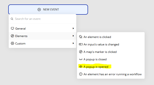

it looks like your trigger is “A popup is opened”
You say you want the user to click NEXT and the toggles are untgoggled, show pop up.
To do this, in the Design editor, click your “NEXT” text element and in the window that opens ensure “This element isn’t clickable” is UNCHECKED then below it press “Add workflow” or “Edit Workflow”. This will take you to the workflow for “NEXT is clicked” then you add your Only when condition to this. the second action in your workflow would be to show pop up.

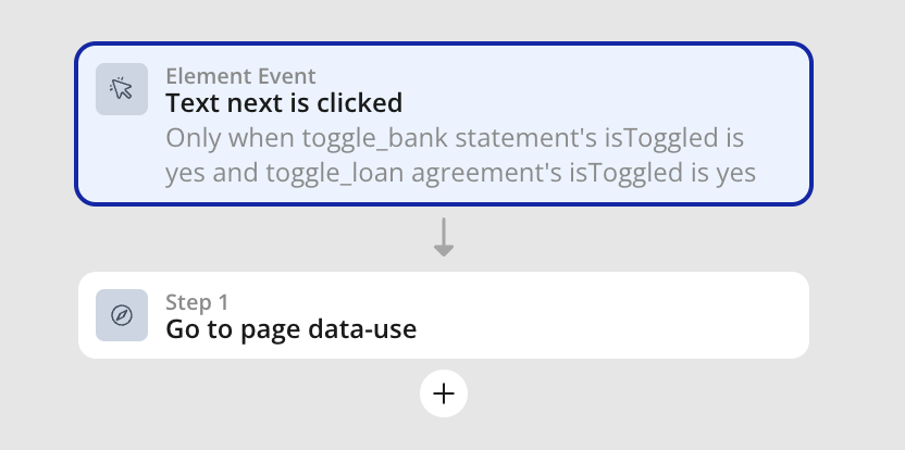

For NEXT to send the user to the next page, I added the reverse condition and go to said page but it’s still showing the popup.
What have I missed?

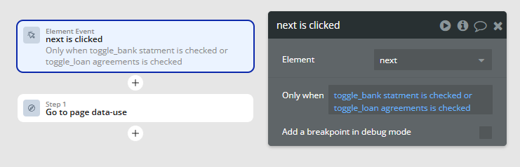

Open the page with debug mode on, toggle on all the toggles and then set the debugger to “Step-by-step” and click NEXT, you should be able to step through and check the conditions in the debugger. The yellow highlighted “Only when” should be green. to look at the values click the blue text the red arrows are pointing to.
Ah, the debugger only shows the first condition for the popup to show
Why is the first condition overriding the second one? Should they be written together under one workflow?
