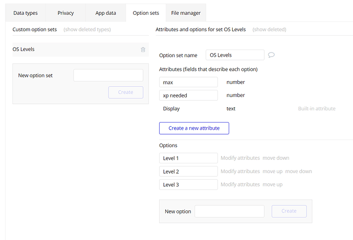

It starts with an option set, and I think the key pieces are the max xp for each level and the number of xp needed to get to the next level (which are attributes of the option set). So, my option set is configured like this…
If we look at Level 2, for example, it looks like this…

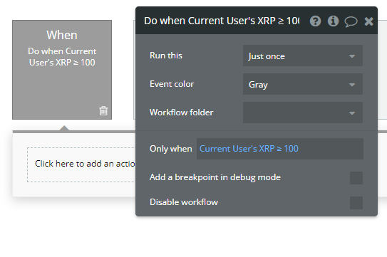

Then on the player_profile page, you’d have a workflow that is triggered when a condition is met… in our case would be Current User’s XRP > a particular number
Then the action would be to Make a change to the Current User’s Level
