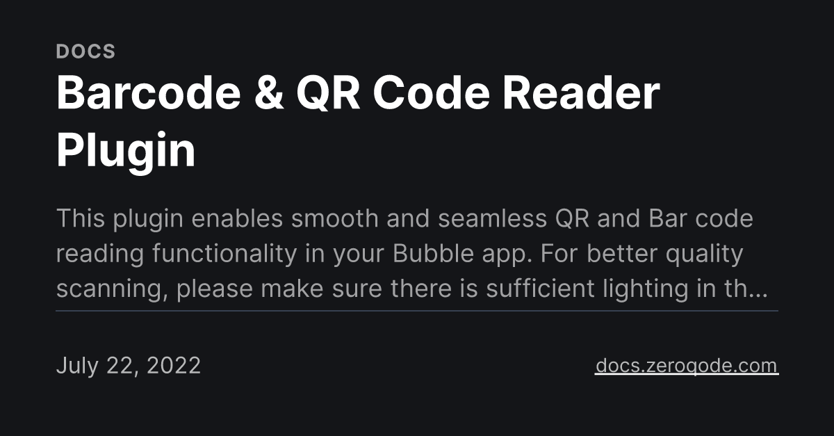

there are 2 reader elements and 2 demos. The newest library that we implemented is supposed to work on iphones as well.
https://docs.zeroqode.com/plugins/qr-and-bar-code-reader-plugin
please check this documentation
