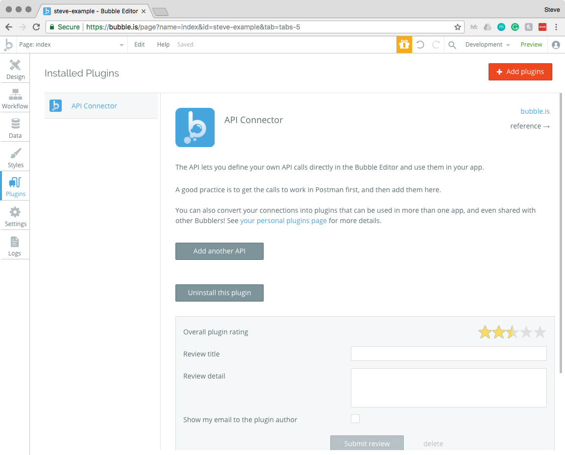

  1. Install the Bubble API Connector

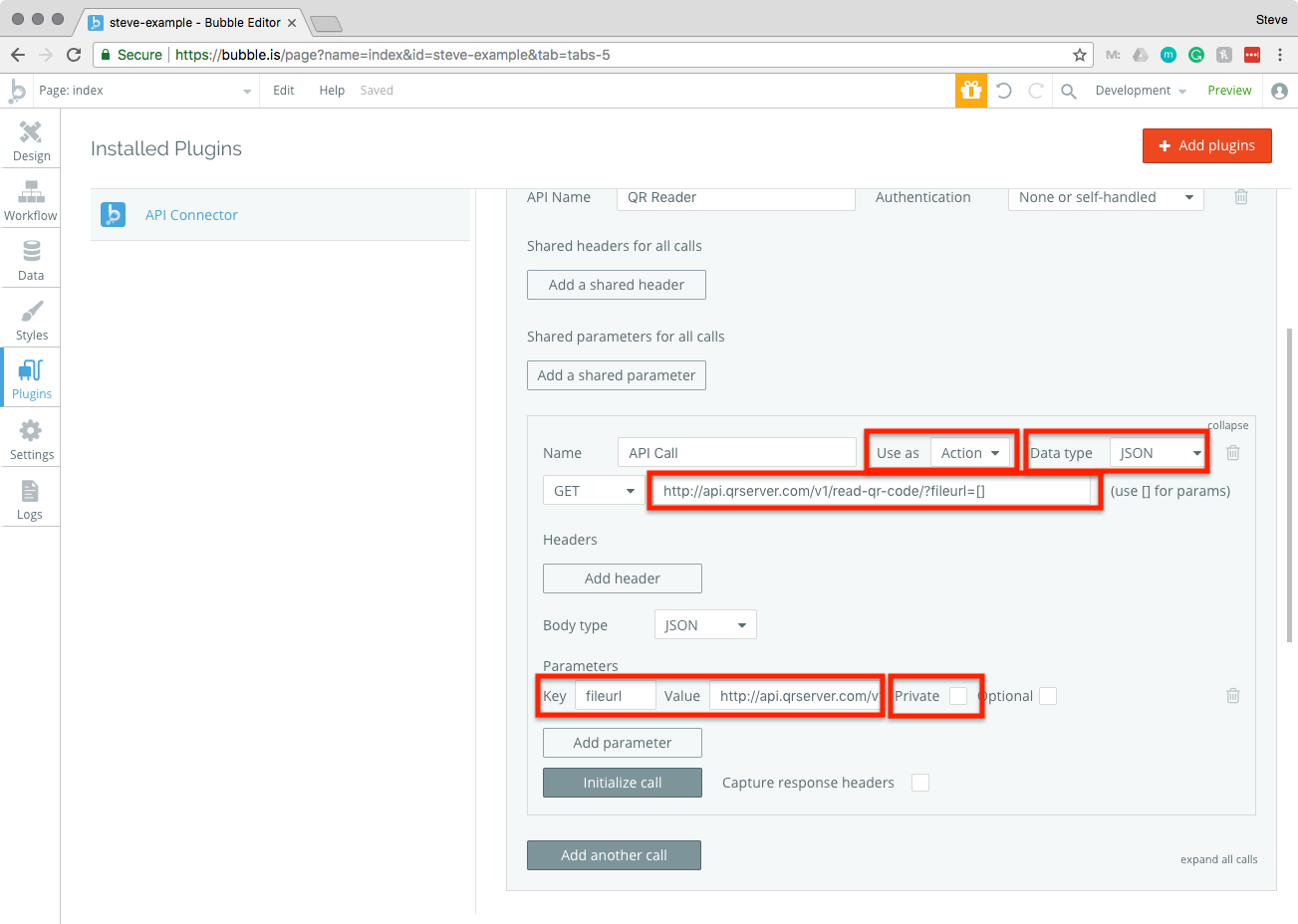

  2. Add a new API and name it anything you want. I used QR Reader
  3. Expand the API call and fill in the following
  1. Click initialize and configure the return datatype
  2. Save

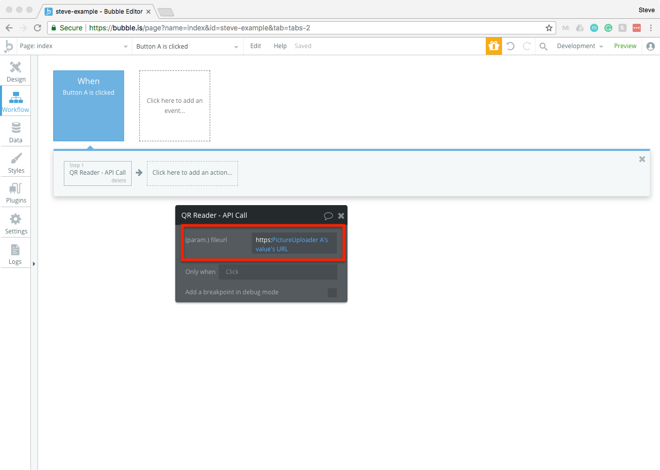

The call is now ready to be used in a workflow. To use it, you will need a picture uploader object. Then
  1. Call the API action with the following parameter
  2. Then get the resulting data elements from the JSON object
