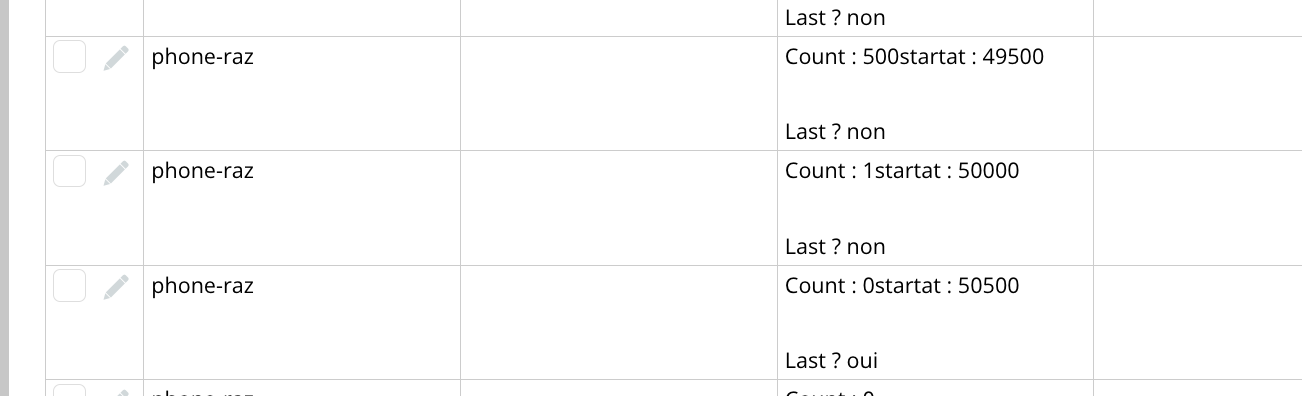

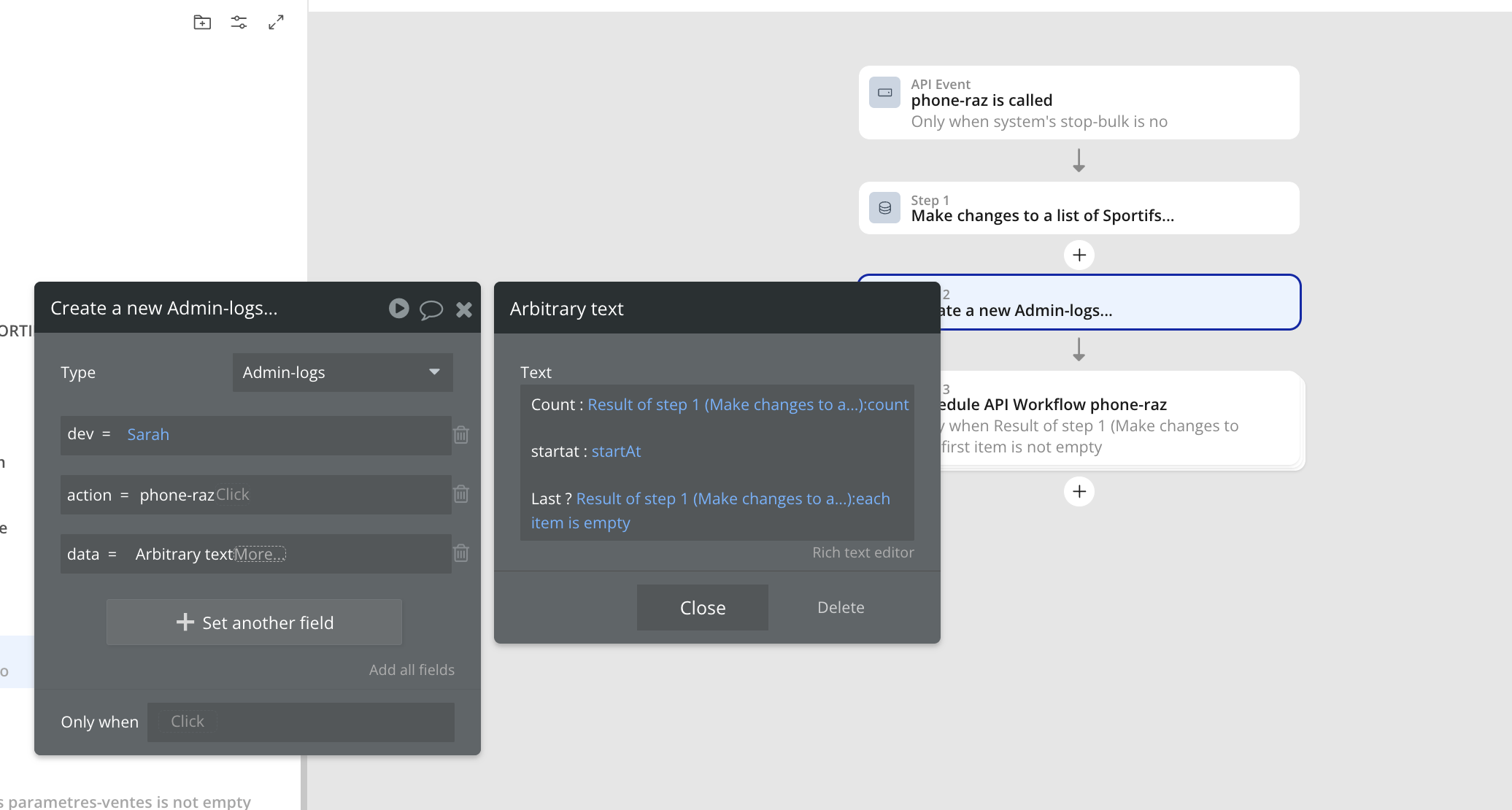

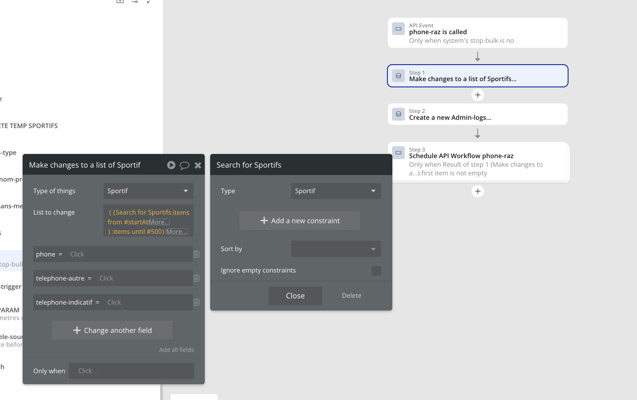

Hello guys, I encountered the same issue, but for another purpose.
I wanted to loop on a datatype data, to change a field (national phone to international).

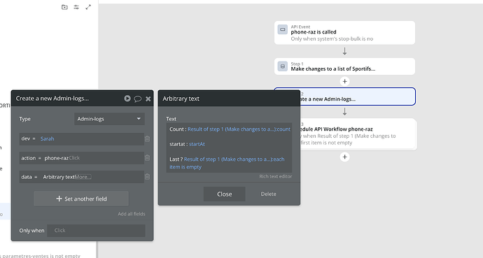

So use to have a backendworkflow with one paramater as a number “startAt”.
I use to create some logs entry to know where I’m in the process :
So it stopped at the 50.000 entry
When I read messages here, seems you think he is trying to retrieve 50K rows, but if it FROM 50.000 until 500, this is 500 rows output, not 50K right ?

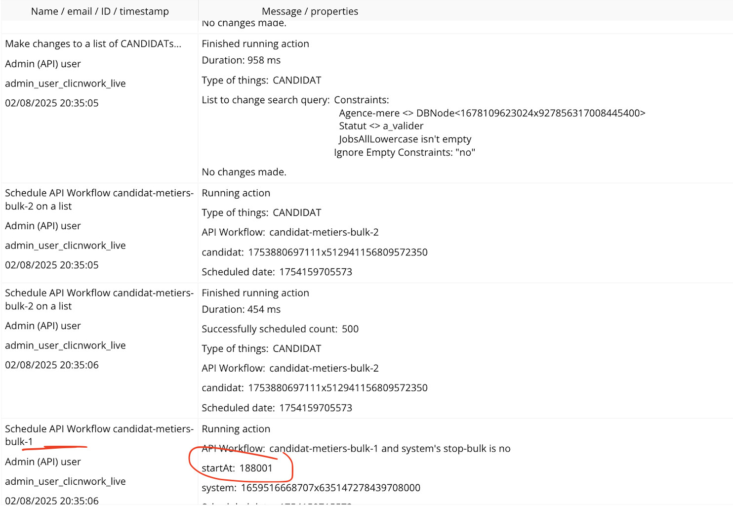

ANd what is strange is on my other app, I did the exact same wf (and not for the first time)
and as you can see, it worked great, as usually
As you can see the item #188.001 is not empty.
So am I crazy ?
Why this time returning item FROM 50.000 is not working ? Do I miss something ?
cc @georgecollier @boston85719
It’s specifically about using items from or cursor to get a Thing at position nin a list. If n > 50,000 Bubble just doesn’t let you do it. It’s not about the number of results returned.

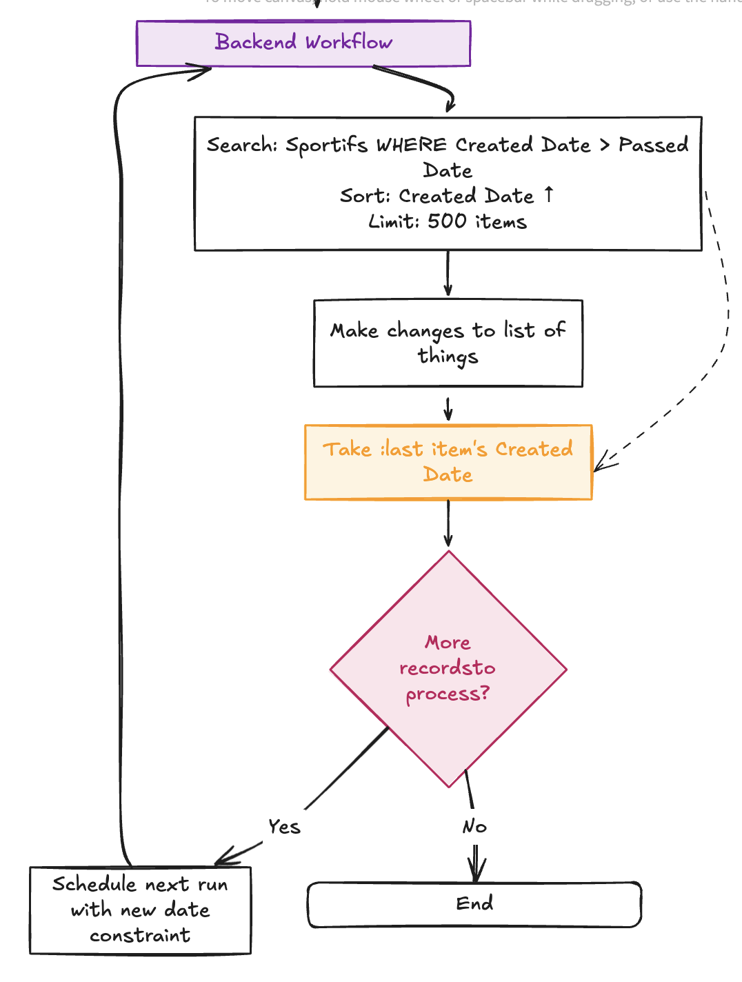

For your backend workflow, do the following:
  1. Do a search for Sportifs sorted by Created date:ascending#items until 500 and make changes to list of things
  2. Pass the :last item's Created Date of the above expression into the next scheduled workflow
  3. Do a search for Sportifs where Created date > (the provided date):sorted by Created date:ascending#items until 500 and make changes to list of things
Ok thank you @georgecollier got it

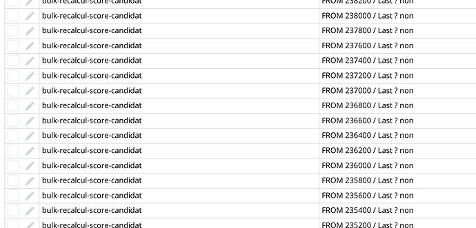

But why the hell it worked on my other app ? that’s crazy.
Another wf where it worked

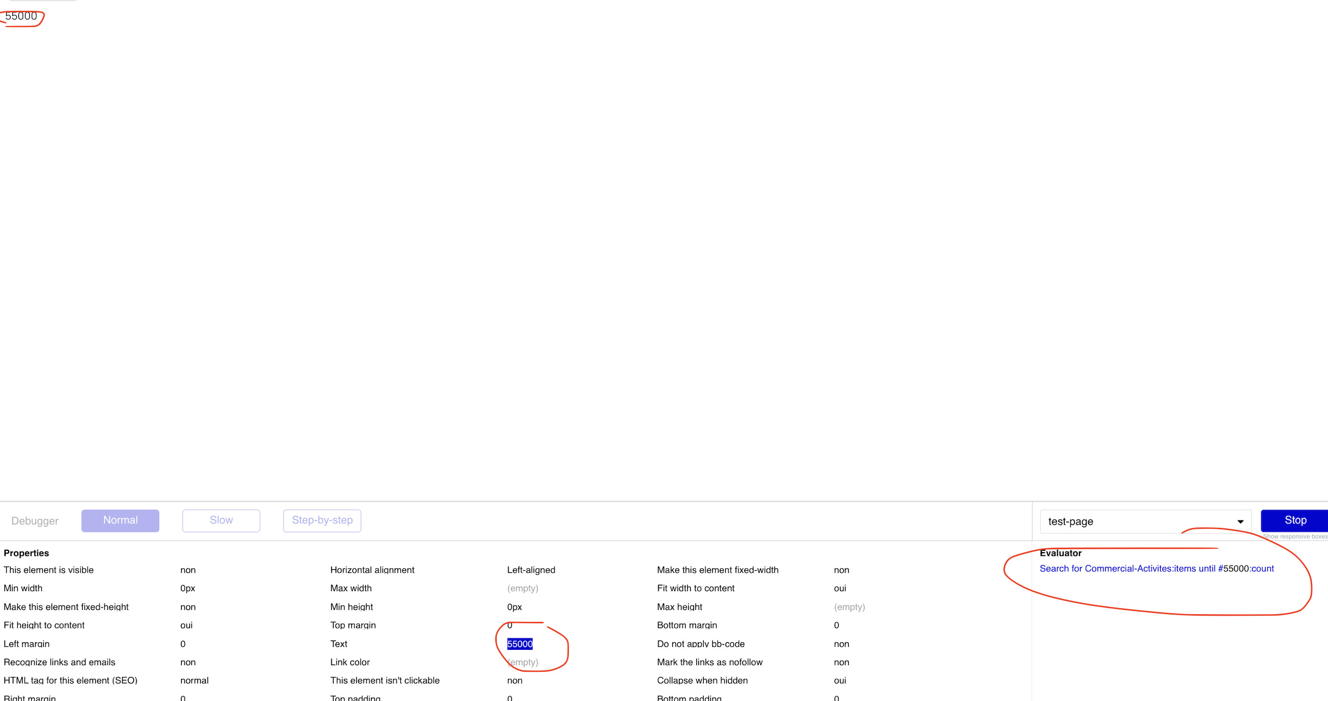

The other app where it worked is on a dedicated plan, is it the difference ?
In the bubble doc they said only sorted lists are limited to 50K but it was not the case here
ANd I can return more than 50K rows
