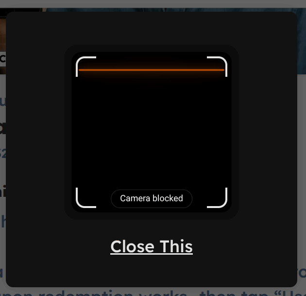

On my app, a user can redeem a discount by either a 3-digit code which the vendor sets:
Screen recording 2026-01-25 2.38.44 PM
Or, by scanning a qr code (no plugin used, only dynamic expression to create QR code and code to create scanner)…
Screen recording 2026-01-25 2.34.12 PM

Also, the QR Code isn’t actually a link. I understand what you mean by it being a link if you look at the url source. It opens the phone with some number that I’m not sure is even anything. The text is actually the merchant’s ID. I’m going to look into why their merchant id shows as a link. Not that it really matters in this case, since I have a built-in scanner that is specially designed to do tasks specifically for this app.
I have a JavaScript to bubble that runs when the scanner scans the QR code and verifies it as belonging to that merchant, which then goes through the process of redeeming the discount. Then of course, there’s the error workflow if someone denies camera access, etc.
Added: So the merchant’s ID doesn’t show as a link, I added TC to the dynamic expression so the output would be rendered as text and not show as a link…just in case someone somewhere decides to use another scanner. It would show as an error and give an error message telling them to use the built-in scanner.
