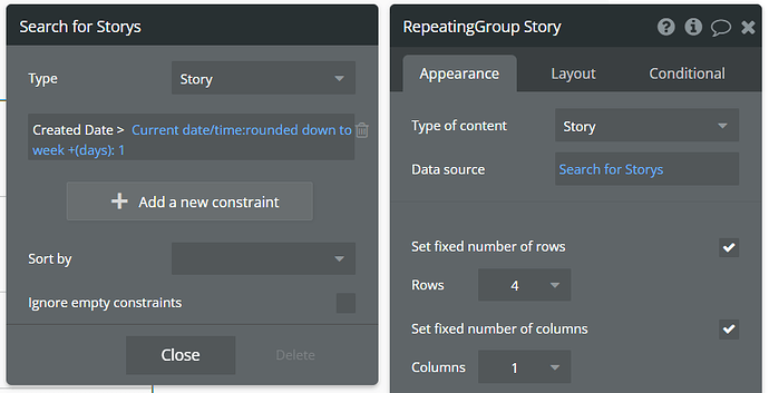

I want to display in a repeating group only “stories”, which are created in the current week. When a new week starts, the repeating group should be empty, until new stories are posted. Does somebody know how to do this?

Hi, everything went out perfectly, but know it’s Sunday (I live in Austria) and the repeating group is already empty. Actually it should become empty on Monday. Do you know the reason for that? I did the same setup like you (see picture at the bottom)

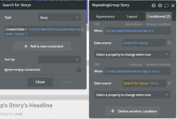

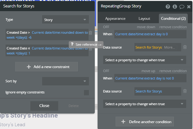

Ah, my bad… unless I am missing something simple (which certainly could be the case), it’s actually a bit more complicated when the day is actually Sunday. I made an example that conditionally changes the repeating group’s data source as follows, and it appears to work as expected.
Hi, now it’s Monday, 2am and the repeating group still contains every story and isn’t empty. I think I did the same setup like you (see pictures at the bottom), but maybe I made a mistake. It seems like a never ending story
Do you maybe have a clue, what else could be done?
I have tested that setup pretty well on my end, and it appears to work as expected. If you want to send me a link (privately) to your editor, I can take a look at your app.
Ok thats funny. I made a copy of my app with the same database and changed nothing to share the link of it. I previewed the copy and now everything worked! Than I got back to the original and it didn’t work. So I made a copy of the repeating group in the copy and pasted it in the original and now everything works out (so far )
Very strange, but the main thing is that it works
